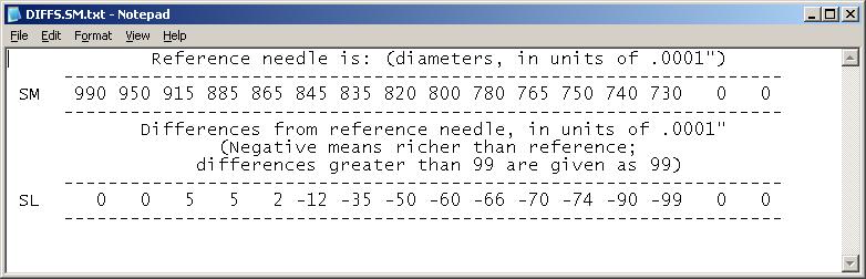

I believe using a "lean" needle should give you somewhat better fuel economy, at the expense of poorer low-range power. I don't have my SU reference material at hand, but as I recall the "SL" needles are only leaner through a few stations (like 3-5) and then as rich or richer than the "SM" needles at both idle & full throttle.
They're easy enough to swap, so try it out and let us know!
I'd try them myself except all my needles (even the new ones) are mixed together and I don't know which ones are which. Some fine day Real Soon Now I'll measure them and find out.
TR3driver
Great Pumpkin - R.I.P
Oh wait, I do have an ancient DOS program with the SU needle database ... here is it's output:

Thanks for the info Randall. I'm rebuilding a set of SU's to keep busy during the winter months as I dont have access to a heated garage. In the Spring they will go on a 4A project car that has Strombergs on it. I'm more familiar with SU's and dont want to go into a whole new learning curve on Stroms. The SL needles should work good enough in the SU's for initial starting and engine tinkering as the car wont be on the road for sometime afterward.
