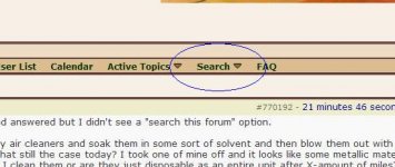

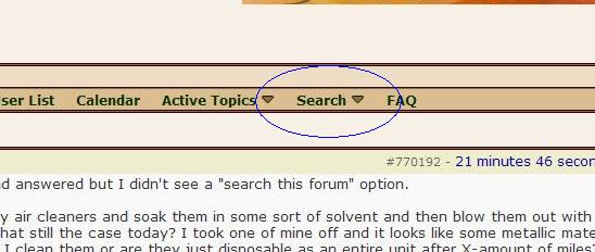

Search is in the bar at the top.

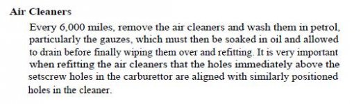

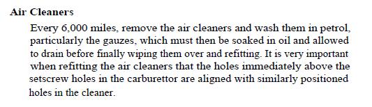

The stock air filters are supposed to be periodically flushed with solvent and oiled. You should have a copy of "Practical Hints for the Maintenance of the Triumph T.R.3" (which was the factory owner's manual for the TR3/A/B). If not, there is a PDF available here

Randall, you are a gem. Indeed I do have the Practical Hints but my house is in an uproar because I've just redone the garages to make a good environment for the TR3A and now my "man cave" is all in piles and covered up in plastic as it is being redone, as well. I have the book and will make my mechanic a copy. The nice thing is that my memory served me well after all these years! My brain is still hitting on all 12 cylinders!
