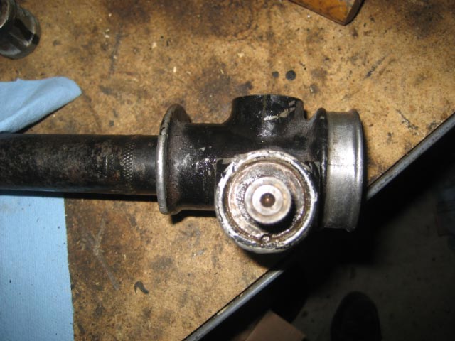

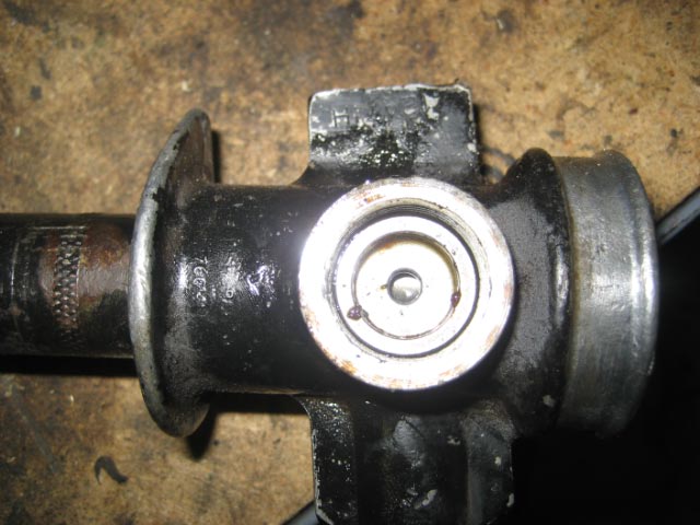

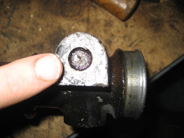

Thanks for your advice. I've been whacking it with a hammer and a piece of wood on the back end of the pinion housing (see photo - finger shows where I am hitting it). Is this the best place to whack or is there a better way? Pulling it out from the pinion end seems to be impossible. The service manual makes it all sound so easy...
Thanks
Myles

Just checked my spare rack - I don't think you pound where you are pounding - that is not the back end of the pinion. Just turn the pinion and you will see the back end does not rotate.
Not speaking from experience other than looking at the manual - from your picture, it doesn't look like you've removed the thrust button/pressure pad (item 13) in the manual. If not, couldn that be hanging up on the pinion somehow?
My main though is this- reattach the lower steering coupling temporarily to the pinion shaft, then gently pry between the coupling and the rack & turn the pinion while pulling out - would that help you lever out the pinion?
Just a thought.
Randy
