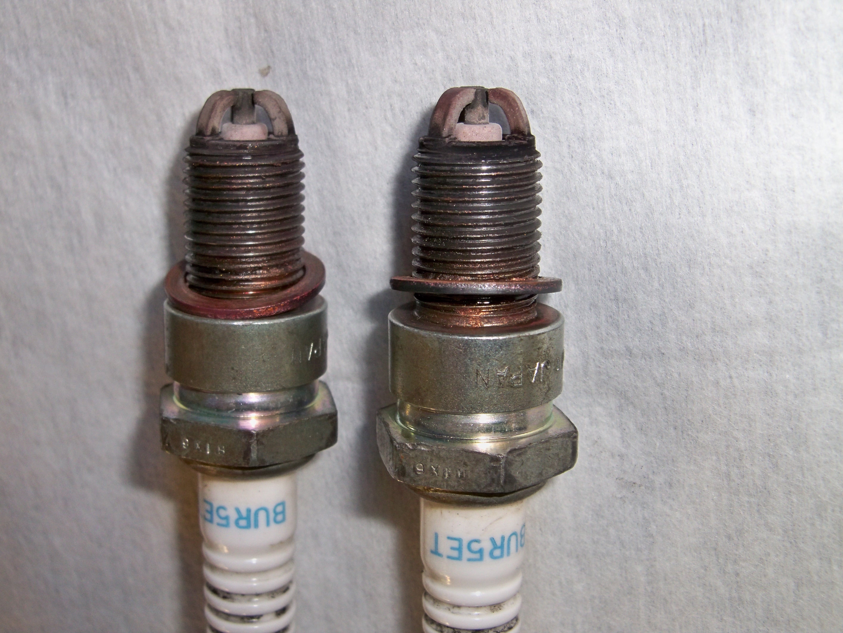

poolboy
I've been using NGK BUR5ET for the past few years.....initially I just wanted to try them out of curiosity having read about them on the Triumph Register Forum
Otherwise Champion RN12 YC would be and were my previous choice.
So either heat range 5 in the NGK brand or 12 in the Champion brand.. always copper.

poolboy
I've seen that before, Elliot.
Here's where I bought them
I tried the 6's but found the 5's to be a little better looking after a test drive.

Gliderman8
Gliderman8
Those plugs look good! My rear three look like that; the front three have more soot. I’ll lean the front carb a little and get the new plugs installed then check after some driving.
