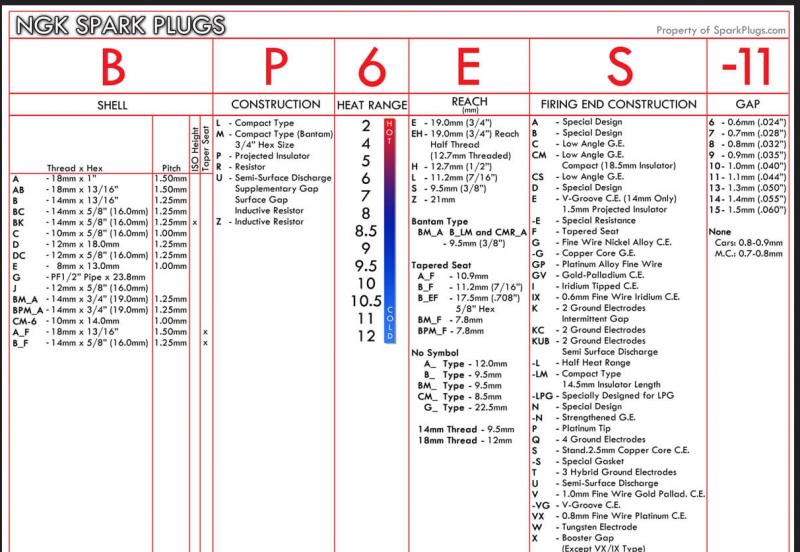

Not big Healey but I ran/run NGK BP*ES in Sprite street and race motors for 20 plus years. Never a problem or failure
steveg
Re: spark plugs
When my engine was tired, I ran BP5ES in the two cylinders that had fouled on BP6ES; since the rebuild, BP6ES.
I don't use resistor plugs because I have resistor wires and more than one resistance is undesirable.
Re: spark plugs
I've tried NGK BP5ES and BP7ES, but best results were obtained with BP6ES.
Ages ago, I had Champion N12s in there, but once they loaded up from stop-n-go traffic, they won't clean themselves off__Italian tuneup antics notwithstanding. That's never been a problem with NGKs, even when I was sorting out a tri-carb (SU) setup from a 3000 onto my original 100/6 engine.
