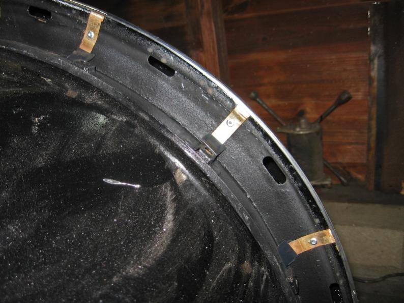

thechileman
I had the same problem getting the beads to sit tight on my TR4. I installed the beads, tightened up the bolts, and THEN reached up in the fenders and bent the tabs over. I had my wife helping to be sure the beads were positioned correctly before I bent the tabs.

I know this may sound like heresy, but on my TR3, I fastened the beading to the outer wings with pop rivets. It makes apron installation and removal much easier. I've had my apron off twice since the resto was finished. By loosing up the screws along the the upper section of where the outer wings attach to the inner wings, you can spread the wings out way more then you need to remove the apron while clearing the attached beads.

The long flange in the engine compartment may need to be cut with tin snips in several places to allow the bead to lay flat against the edge of the fender.

Tom, et al... I don't have to mess with the aft section of the bead since it has already been pop riveted to the wing. I would have to remove the apron again if I were to try the 'heresy' approach with the pop rivets on the single tabs. I think I'll try bending the tabs with the bead firmly in place after the wing is as tight as I can get it and the bolts are secure. The gap is only from zero to under 1/8 so it won't be visible under the bead. I sure don't want to force it and spin a nut in the cage. Rick...

It all depends on how good your old ones are. I re-used all of my original beading. It is all in great shape (despite being from a car almost 60 years old) with the exception of one of the front beads has a very tiny dent in it about 2 1/2" from the bottom. If I ran with front bumpers, you might not see it. Actually, if you didn't know where to look, you might not find it.
Problem I've had with new beading is the curve of the long tab, it does not match fender. I've cut the tab so I can bend to match. Don't like the way it looks. I reuse original tab when I have one available

My Eastwood shrinker/ stretcher works well for that. HF and others carry them too. Tom
