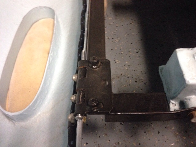

It seems the resting point is now the bumper brackets. If everything is aligned well, the the non-stock method would be to secure the bonnet to the bumper brackets. A door hinge with a U bolt or welded to the bumper bracket and the other half bolted to the bonnet. Use a ring locking pin to allow quick release. My Speedwell bonnet tilts forward with a similar method.

image.jpgimage.jpgReid
Here are two pics of the hinges. The mounting bar came with the bonnet. They are just simple door hinges, which are "pinned" with a simple bolt while I am working on the car and a ring pin when driving.
