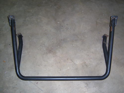

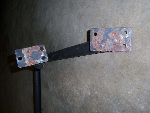

I recently bought a rollbar on eBay that is supposed to be for a TR-6. The seller says he had it on a 1976 TR-6. It would mount on the wheel wells, but the convertible top mechanism hits it and won't go all the way down. It will fit inside the convertible top when it's up. Does anyone know if this is the correct roll bar for a TR-6, or what car this roll bar should be for? Thanks to all for any help.

I don't know the required measurements for the TR6 but if it is that close and the bolts will go through the frame, it probably is for a TR6. SCCA use to require a cross brace (a diagonal piece for strength) to be approved for racing so the roll bar was not specifically designed for SCCA. It seems dumb that it is not designed to work with the convenience of top positioning in mind. Worse case you can have it modified to work with the top.

This unit may not be for a TR6. The "feet" on the bottom are not twisted on mine and it does not hit the frame of the top. It's close, but it will not hit. I made sure before we drilled any holes.

Thanks Paul. This one actually mounts higher, up on the wheel wells. If anyone knows what it really fits, I'll probably put it back on e-bay.
Brosky
Wheel well fit was for TR3's, if I'm not mistaken.

Roll bars that mount on the wheelwells and cargo floor are much stronger than those that simply mount with all 4 legs on the cargo floor.
But the your bar is definitely not from a TR3. The two TR3 wheelwell legs are very short compared to the two floor bars.
Maybe a Spitfire?
