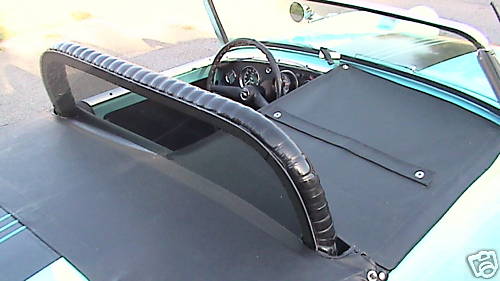

Here is one way Robert DuQuette took care of this issue. The other alternative I've seen is to use a flap with Velcro and twist and lock type fittings, brain isn't working to pull the proper word up. I kept an old top for use as spare material for my tonneau so I could match the "aged look" of the fabric. I was quoted in the 4-5 hours worth of work price range, figure $200 for a custom modified cover.

Here is another way to do it. I was finally able to get this file size reduced and changed from a .bmp format. This looks to be the nicest and cleanest way I've seen this done. This is the nicest piece of craftsmanship I've seen to date.

Wow! That's an artist's work. I'm taking all these method's pics to my trim guy for him to get "inspired". :wink:

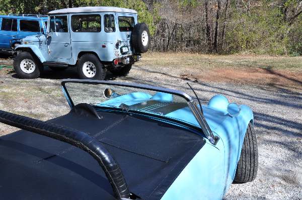

Done deal! Looks great if I do say so myself. Took me and another BE nut friend about 3 hours to finish the fitting.
Boy that sucker is TIGHT. You could bounce a quarter off the thing. I'd post pics but I'm tired and it's dark.
Helped another friend install his new engine in his old
Iron Pig Cruiser AFTER the tonneau install.
I'll post tonneau pics tomorrow.

Pics:
Gundy
Gundy
There is only the zipper up the middle. The flap with the snap
at the rear of the door was how it was designed. The trim guy just cut he holes at that point. The flap with the snap keeps
it all snug. It was bear making all the snaps etc. Tugging and pulling till my fingers were sore. We started with the fronts next to the door. Do one then tug for the next one. Do that to the two (one at a time) next to the rear view mirror.
We had 'em so tight you could barely get them over the pins.
We left all those attached as we did the pull buttons and remaining snaps. Last was the snap buttons at the door/roll bar.
The crimping toll was a must. The little cutter tool not so much help. The best thing for cutting the holes was a small Swiss Army knife. Hehe...I had a blue one on the BE's key
fob already. Those little scissors are the bomb for cutting the small holes and the knife blade went through that vinyl like it was butter. I just cut slits for the little prongs that join the snaps top to the bottom. Folded the over with
a hammer.
I need to buy some more of the button snaps to finish the
flaps that attach the cover to the inside when folded back.
After a couple of days of sun baking they work great.
We paid attention to the direction the snaps let go (where the writing is located) and positioned the snaps so the tension was to the other side of the snap. They really hold well. It holds so well that you can't get them off without undoing the center zipper.
