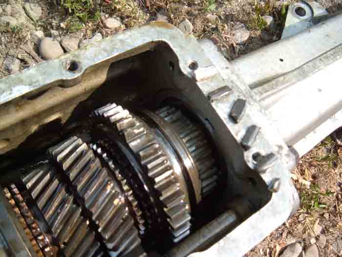

Had the distinct pleasure of changing my TR3A gear box this weekend. To make a long story short a tooth was chipped on the mountain tour at TRF summer party last year. After some driving around back here in Ohio and hitting a pot hole this spring taking off quickly in 1st a bunch of teeth were sheared off. There was no 1st or reverse after that.
Got a really good used tranny too, cheap. Got a question about the numbers on the box. There are several numbers but which number is the one that would designate about what year it would belong to?

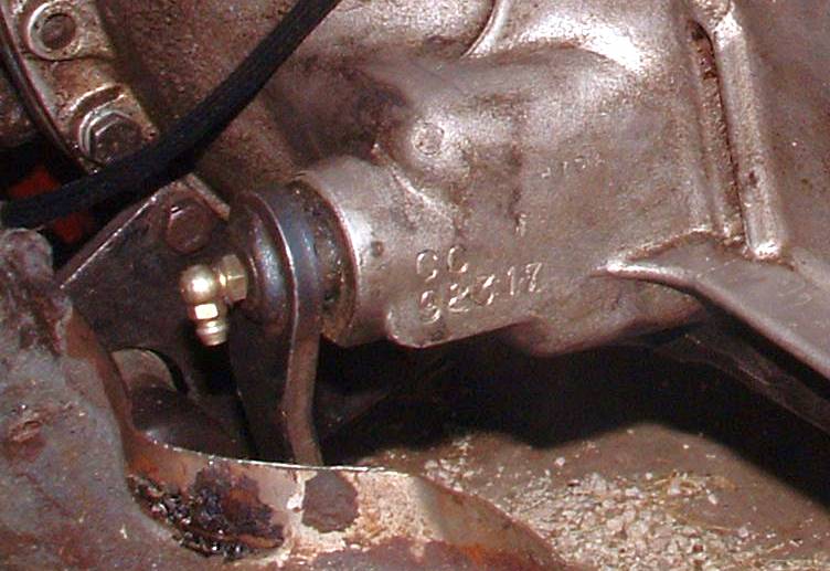

The book says there should be a TSxxx number stamped on the LH side; but I just checked two different early crash boxes and couldn't find a number on either one.
This is where it's located on the later gearboxes, though. The CC prefix indicates it's a late TR6 gearbox (which I have installed in my TR3).

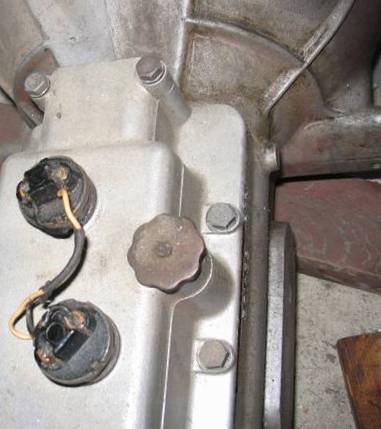

With the front valance off, the rad out and maybe the engine out as well, the Frame number is stamped onto the top of the frame mid-center looking straight down from above.
The gearbox number is hand-stamped onto the boss (flat bulge) on the side of gearbox casing half way down. I think it's on the side a bit above and to the rear of the clutch slave cylinder - but I can't be sure. The casting number in cast into the top side as shown just below the dip-stick for checking the oil level and re-filling my original gearbox. All TR2s, TR3s and early TR3As had this dipstick.

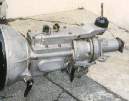

JP,
-The body number is on one of the 2 brass plates on the bulkhead above the battery.
-Frame number (its a design update number I think) is a welded-on plate on the top of the cross member just ahead of the engine. Kind of hard to see.
-The TR3 gearbox has a SN stamped on a boss on the left side. Easy to see if the transmission cover is out of the car.
John

The original tranny had a wine in first gear. This one does too. Maybe something in that vin line that does that. This is the 3rd tranny in this car. I'll have to dig out the original one buried deep in the shed to match vins.
TR3driver
Great Pumpkin - R.I.P
I believe that is right. 1st & reverse are "straight cut" gears, which whine a bit. 2-4 are "helical cut". Notice in your photo above how some of the teeth are at an angle, others are straight. The straight cut gives more strength and efficiency, but makes more noise.
