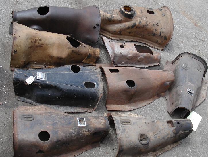

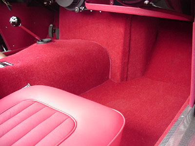

Both BN1 and BN2 gearbox covers come up on Ebay periodically and yes, there is a big difference between the two which also affects the trimming (carpet, vinyl). Gearbox tunnels.jpg
The lower five in this photo are BN2 tunnels.
This is a trimmed BN1 tunnel.
This is a trimmed BN2 tunnel.

You can probably use the trans cover from any four speed, side shift gearbox. There is also a vertical panel that goes between the tunnel cover and the firewall bulkhead. So BN2, BN4, BN6, BT7 before center shift, BN7 before center shift.
Check to see what gearbox you actually have.

Bill thanks for the clarification. My, where did you find that cache of gear box covers? Are any of them for sale still?

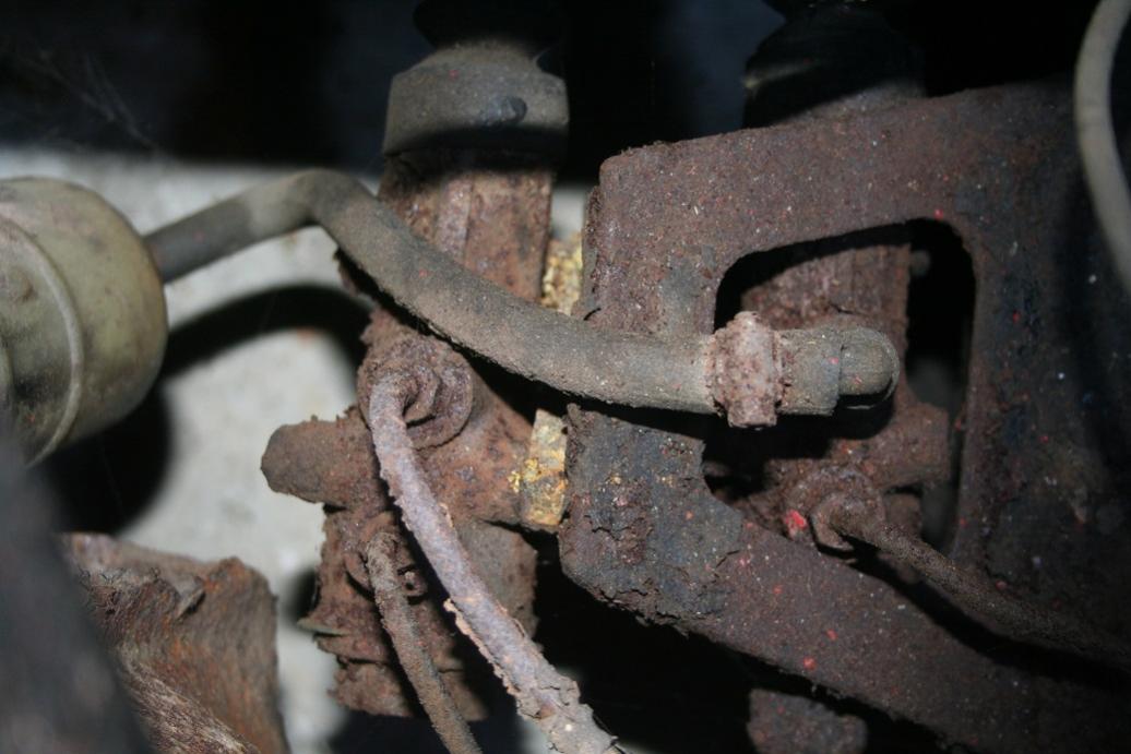

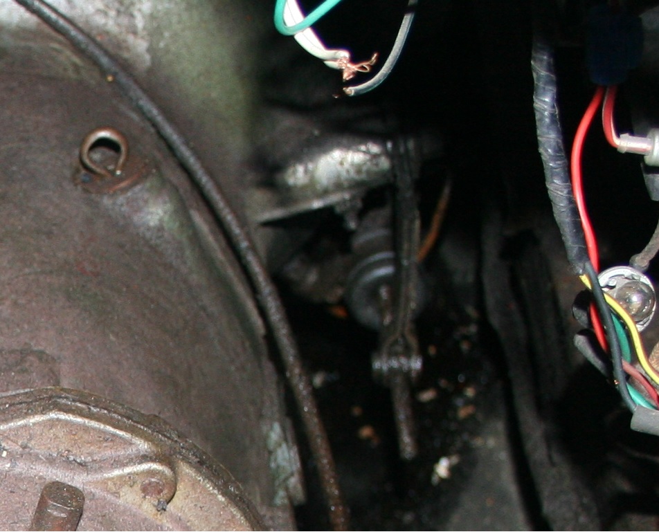

I am going to take some photos of this conversion. According to the PO the box is a BN2 and others have confirmed this from visual inspection. The hydraulic conversion was a PO modification, rather than a dealer or official modification. I have a lovely passage in a letter he sent me where he describes the moment he made the decision to do this modification. The linkage broke with the clutch depressed and the car in gear, sitting at traffic light in Manchester.

Here are 2 not especially good shots of the master and slave end for the clutch. You can see how the PO mounted the master inside the brake bracket and then mounted a reservoir close by. It looks to me as if the slave was then mounted to the bell housing and used the last mechanical link to the clutch.

That looks like a BN2 gearbox.
The gearbox cover cache is not mine. I found the photo on the web last year when I was researching the positions of the carpet snaps - mine had holes all over the place.
There is a rod in the mechanical clutch linkage that is prone to breaking. In fact the PO of my BN2 broke it and welded it back together. 'been fine for over thirty years. (I know, it'll break the next time I drive the car now). So your story is likely true.

Yep! That's a BN2 transmission. Looks to be a clever conversion but the original is so simple. I'd go back to mechanical. Kilmartin Automotive Sheetmetal can supply every thing that you need.
All 100 owners have a story about the mechanical linkage, including me. But I have retained the mechanical and have had no trouble since I sorted out the problems. This consisted of restoring the set up to original. Believe it or not, when he designed the linkage, Geoff Healey knew what he was doing!
At a recent club 'garage day' I had an opportunity to inspect another club members 100. This car had the most awful modifications to the mechanical clutch release system. I am going to recommend to the car's owner that he fit a KAS linkage.
