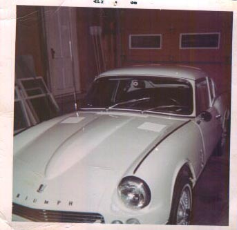

I found the review interesting. The '67 I had (photo) was a little different than the test car in the report. One of the interesting differences is that mine had a 7,000rpm redline and it was no stranger to it. It could easily reach 55mph in 1st gear. The only real complaint I had was that the clutch would slip badly if it was dumped under power. It was bad enough that the car could just sit unless the throttle was backed off so it could hook up. But, if it did hook up the tires could raise a considerable cloud of smoke. The article remarked that the mileage was 22 - 28. Mine was 33+/-a couple using premium. It was hard on tires. Even worse than the '65 Pontiac GTO I had at the same time. I had a set of 4 Goodyear radials wear out in 3,000 miles. What can I say, I drove it hard and loved every minute of it.
