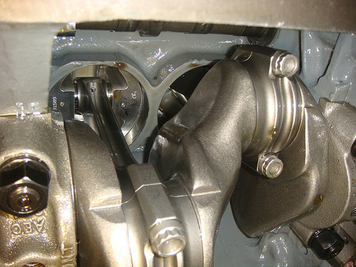

Here's what the inside of my race motor looked like after a couple seasons with the internal block coated.

Dougie, Your inside engine paint/coating is better than some exterior restorations I've seen over the years. Why is it blue?

The whole point is to seal the casting's pores, allowing the oil to drain back faster and theoretically keeping the oil cleaner. You don't need Glyptal to accomplish that, as seen in Dougie's photo above.
