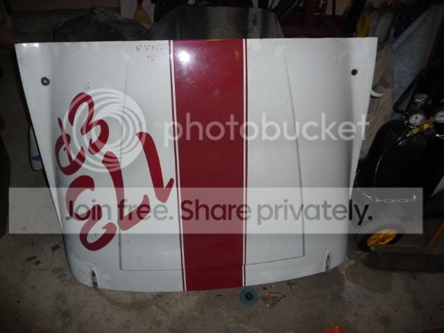

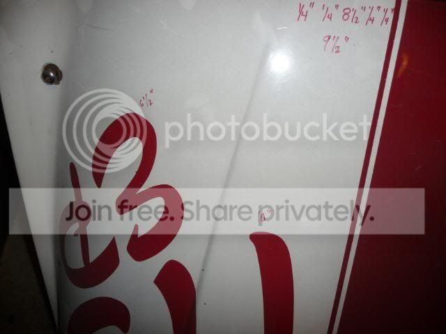

So tomorrow I am taking the Boot and Bonnet to the Soda Blasters. Kinda feel a little bit bad about it like I am erasing a bit of the history of the car. Took lots of photos and measurments of the stripe and numbers so I can replicate at least the stripe after I repaint.
Here are the before pics.

Thanks Pat,
Unfortunately, not quite so pretty underneath it all :smile:
But it will be!

Picked up my panels yesterday and they look pretty good for 50.
Looks like I have an issue with the Bonnet Hinge mounting point on the passenger side where it looks like it was elongated to alow for some adjustment to fit. Also, the mounts for the hinges on the boot lid, one side has bigger mounting holes for the hinge and I assume that is not correct.
