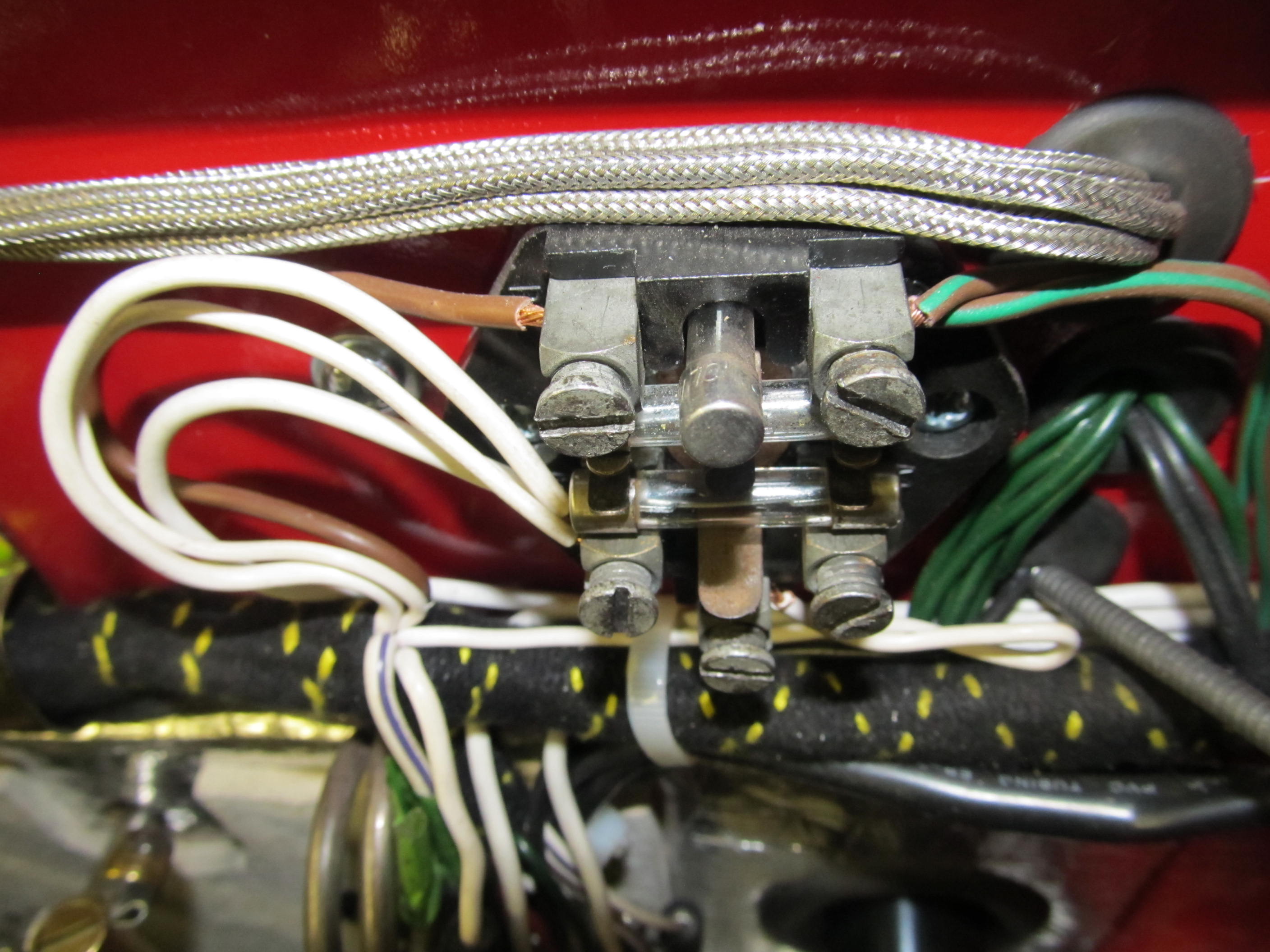

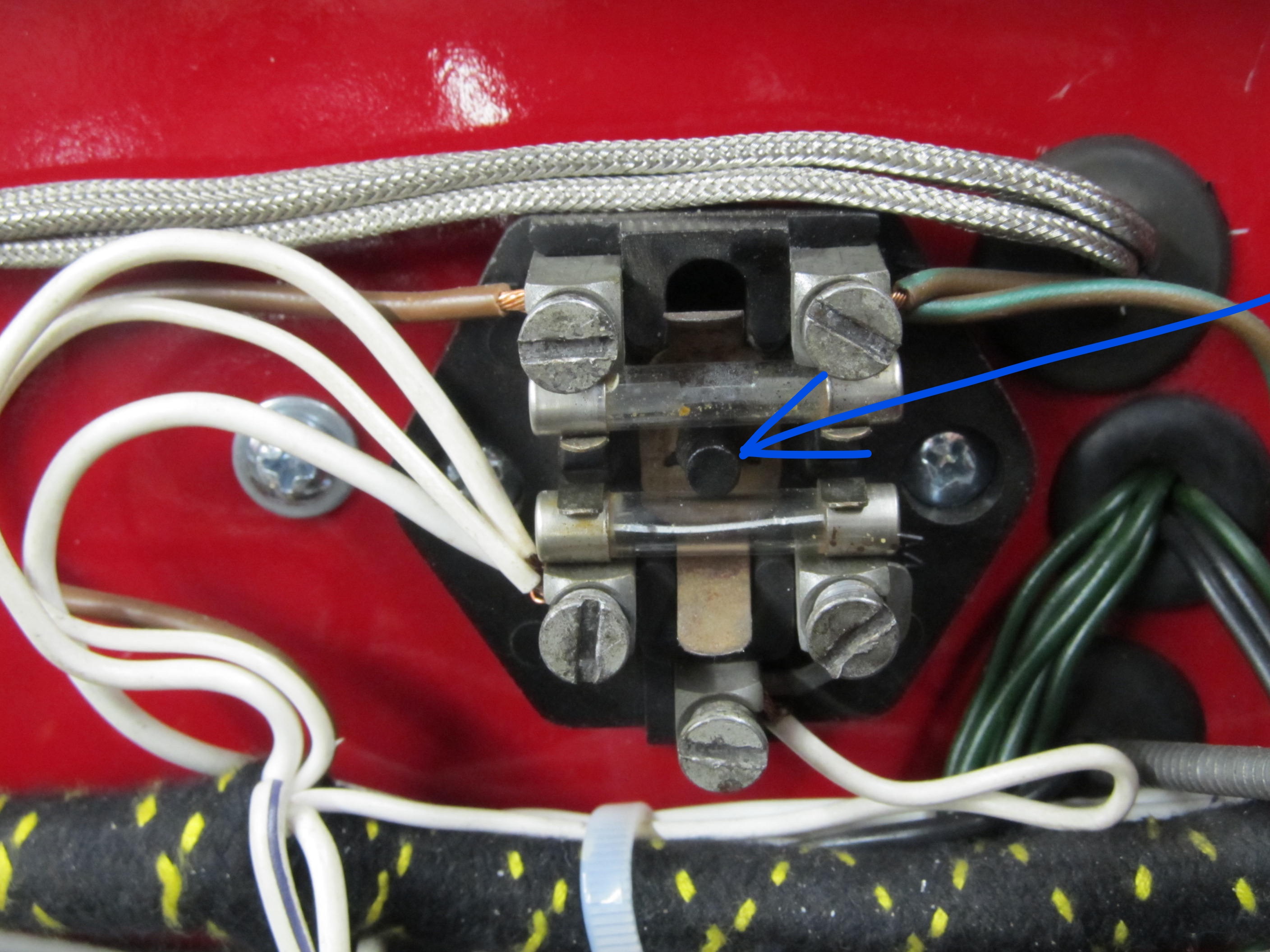

OK, This is a real shot in the dark but....The white wire that goes to the coil continues on the lower fuse in the fuse block and supplies the power to all the accessories. In the fuse block, there is a bakelite post/pin that sticks out between the fuses (this post also holds the metal clip that holds spare fuses in), if this post is broken off/missing it's possible to put a fuse in in such a way that it bridges the 'always hot' brown upper circuit and the sometimes hot accessories circuit. I said it was stretch but I offer it as something to check.

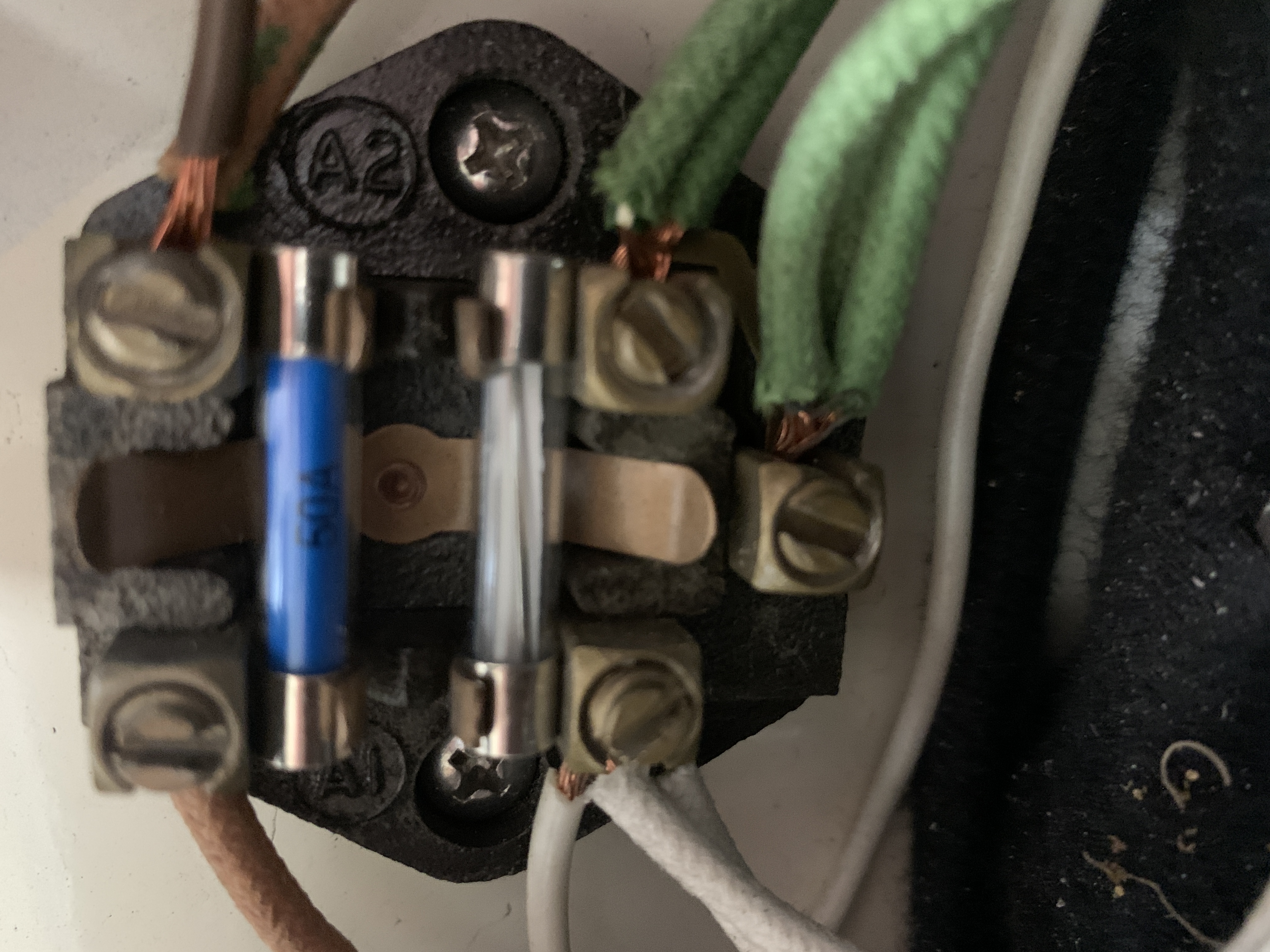

My fuse block looks a little different without the post and the clip is riveted on. I'm sure what happened is something bizarre as you have suggested. Now that you have mentioned this how exactly are the spare fuses held?53BF8E40-CE47-403B-9EC0-A27B4FF7AEE6.jpeg

Interesting I didn't know there were different fuse blocks - I have two, a BN4 and a BT7 with the pins, I see yours without the pin but I don't know if it's possible to put a fuse between the contacts - it looks like there are small triangular points sticking out between the fuses that could prevent one being installed wrong...I said it was a long shot. Could there have been something else bridging the two fuses?
I attached another picture to show the spare fuse holders, that's what the other metal thing is for, keeps some spring tension on the spare fuses so they don't fall out.
