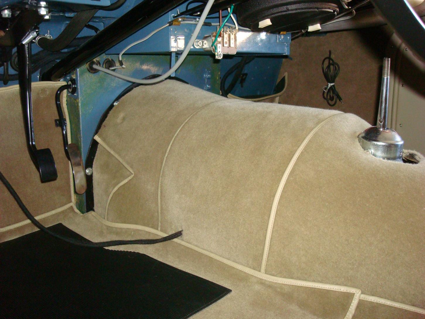

What is the correct routing for the wire off the transmission to the relay behind battery box? My tunnel had a hole in the side with a grommet in it so I was thinking the wire came thru there and up the side. I sure don't like the look of that. Now I have to put a plug in the carpet and relocate the wire.

Thanks Frank for the information. My trans cover only has one hole on the top for the battery box drain. Other than going thru the hole on the side as shown I see no other way for the wires to go.

Forward under the cover to the firewall, then up the firewall to one of the grommets there. That was the original routing on Stags, and I copied it to the TR.
I didn't have them hooked up yet in this shot, but should give some idea

Thanks Randall for clearing that up, I'm going to re-route the wires and put a small carpet plug in the hole over the grommet.
