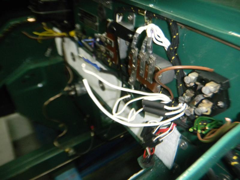

here is a picture of what i am talking about.
the white wire to the bottom goes to the OD relay, the one bent in a "U" goes to the fuel pump, the one bent in a loop goes to the coil.
the other white appears to go to wiring inside the bulkhead. i would assume they all get connected to the same terminal on the fuse block but just wanted to check since the wiring diagram does not show the other white wire.
The brown wire is for the horns and it gets a 'dedicated' terminal with a 50-amp slow-blow fuse. All the rest go to the other terminal and get a 35-amp slow-blow.

i think i figured this one out. on the wiring diagram they show running a white wire out to the coil and then one back to the fuse block. instead of doing that, the harness makers just ran a wire to the fuse block. same result and less wire. makes sense now.
as for adding more fuses, i am going to look in to that as i figure out how the harness is run under the dash. then see what i can come up with. certainly looks like a few in-line fuses are in order at the very least.

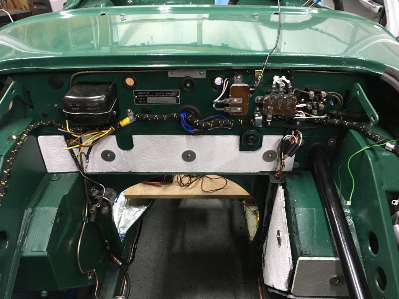

So far mine has been perfect also. i did start pulling my wires for my fuse sub-block. i bought one off of Amazon. should be here Wed. i got an 8 terminal block so i have room for a driving light circuit and have one more just in case. i plan to lay it out just like the Hart set up above.
in stead of pulling out my old fuse block, i am leaving it in. on the left side of the 35amp fuse will be my hot wire from my switch and the wire to the coil. on the right side of that fuse, i ran one green wire headed to the power supply block on the new fuse block. then extended all 5 green wires, the fuel pump wire and the OD relay wire inside. I also ran one red wire from the front of the car for the fog/driving lights. this will go to a switch (not sure where just yet) and then to the fuse block. pic below
on the driving lights, i was considering getting another wiper switch and hopefully a plain knob to put in the dash. Not sure where. looking for ideas on where to install the switch.IMG_0209.jpg
