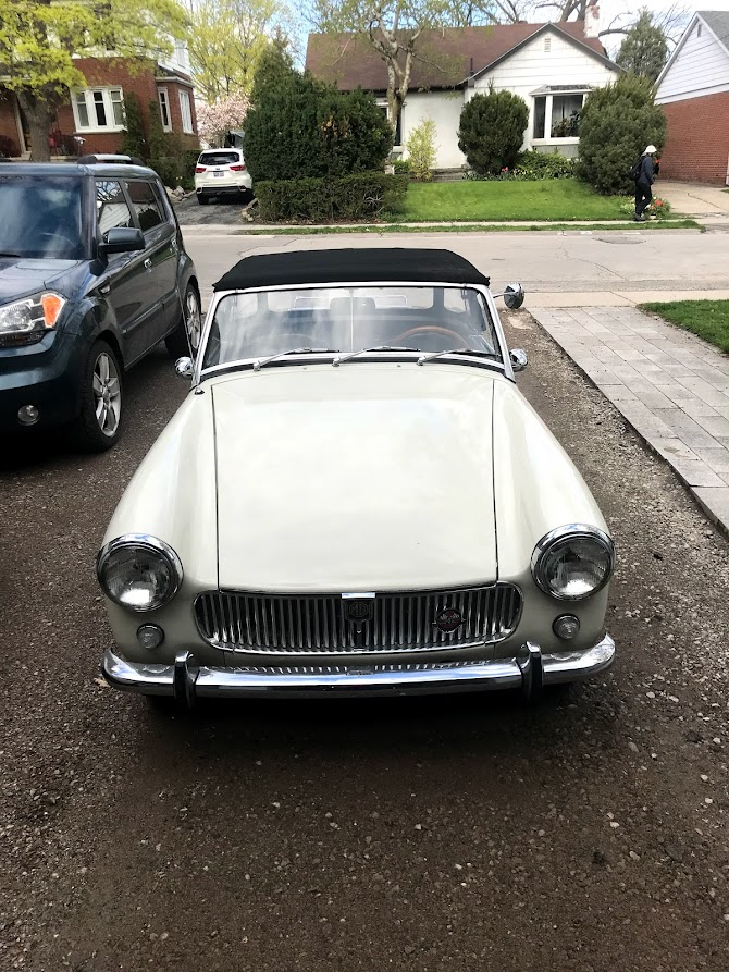

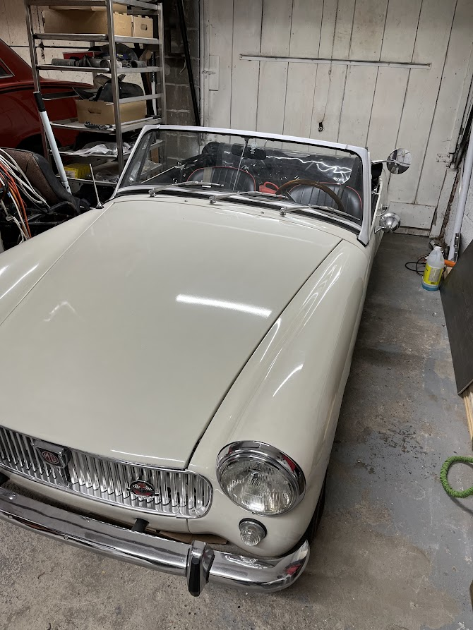

And Ms Triss is home from storage again. Took two tries this year. (Note to self next year bring a can of gas also) - I store the car in a condo garage of the Sister in law of a friend. Charged up and reinstalled the battery and strongly turning over but no love. I almost wonder if someone drained the tank over the winter. Certainly, second try, a gallon or so of fresh gas and some starter fluid and we had lift off!
This year (as every year it seems) is to get her reliable. I still think the mixture is wrong and there is something draining the battery - but happy she is in the garage. Would also note that yesterday was 'drive your British car day' (at least in the UK) so I got to do that some - even if just the 12 miles home :D

That's quite an interesting and personalized Midget, with the later model chrome bumper, old style grill, lack of side marker lights and the beehive turn signals. Show us more of this custom creation.

well spotted.

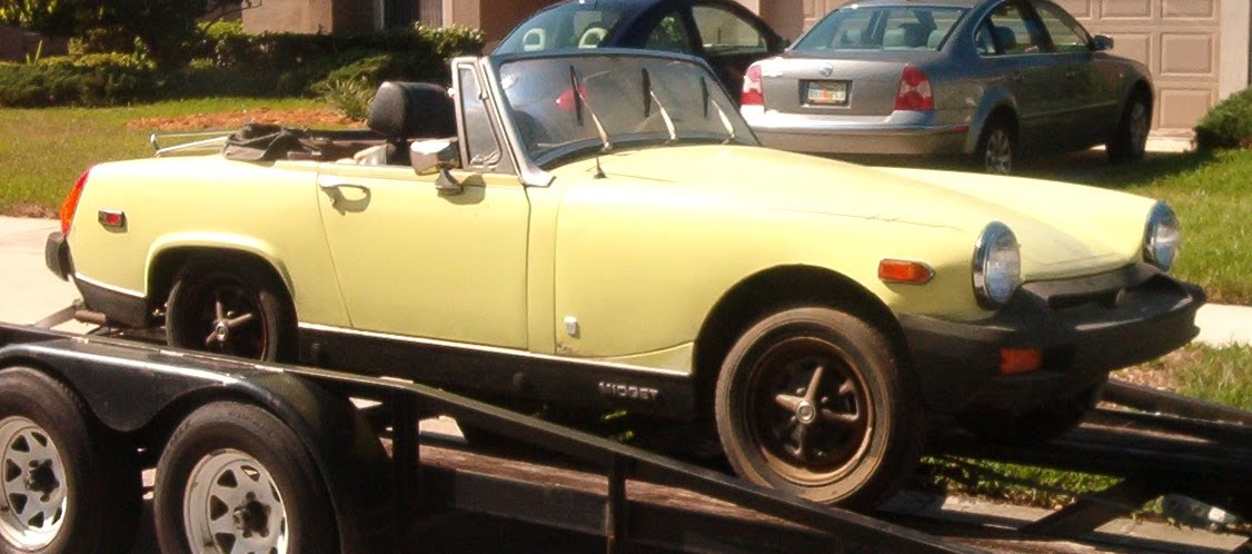

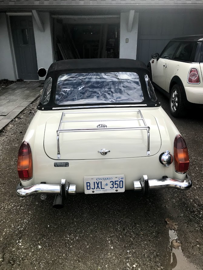

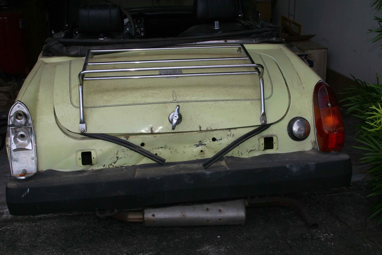

1976 California Car - I am the third owner and got it in Florida so hardly any rust.
started in my care like this (2004)

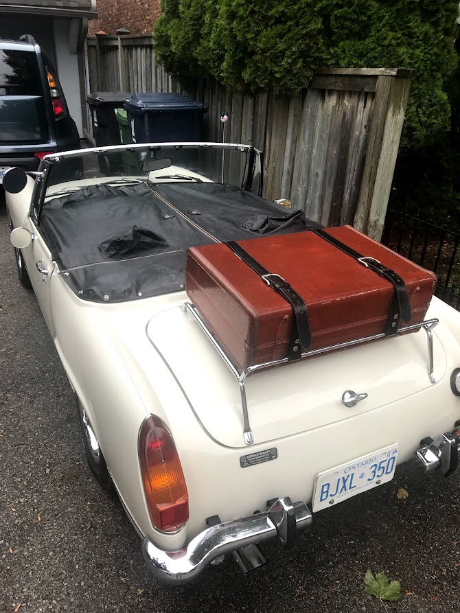

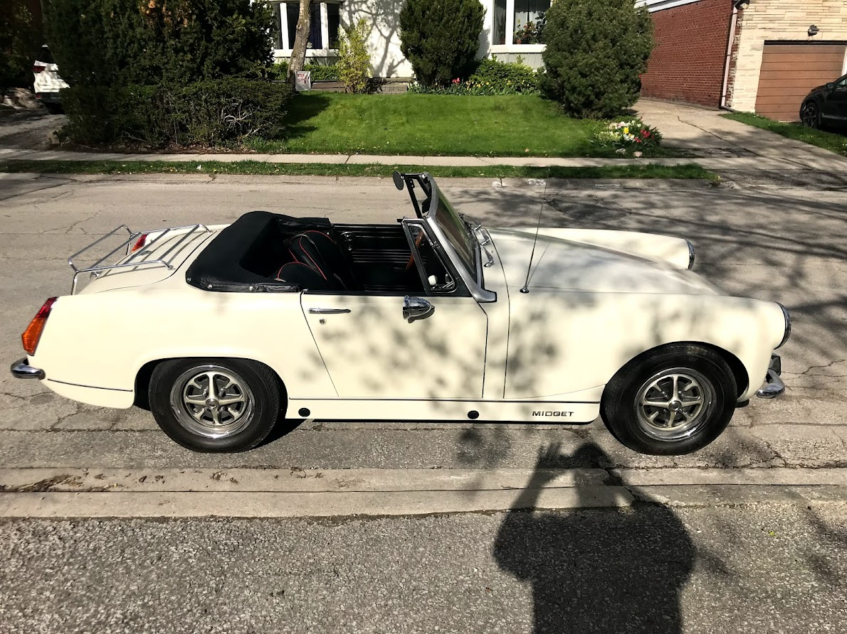

Had it converted to chrome bumper/ side lights deleted/ reverse lights deleted/ and as spotted 72-74 bumpers and 63? grill. Painted Old English White (98 MGF actually)
you can just see the harley stainless steel muffler and motorcycle signal used as a reverse light - and the aston gas cap.

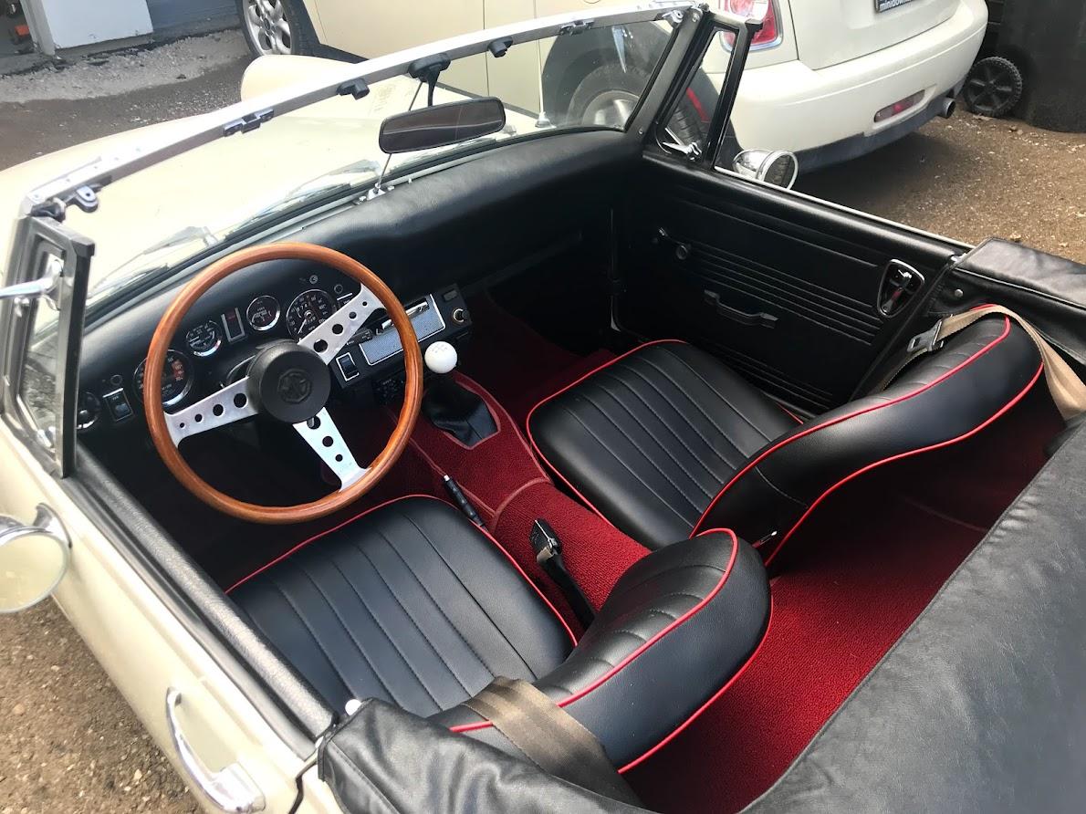

wood wheel, new gear knob, deleted the head rests, red carpet interior
of course a suitcase to store the parts that fall off

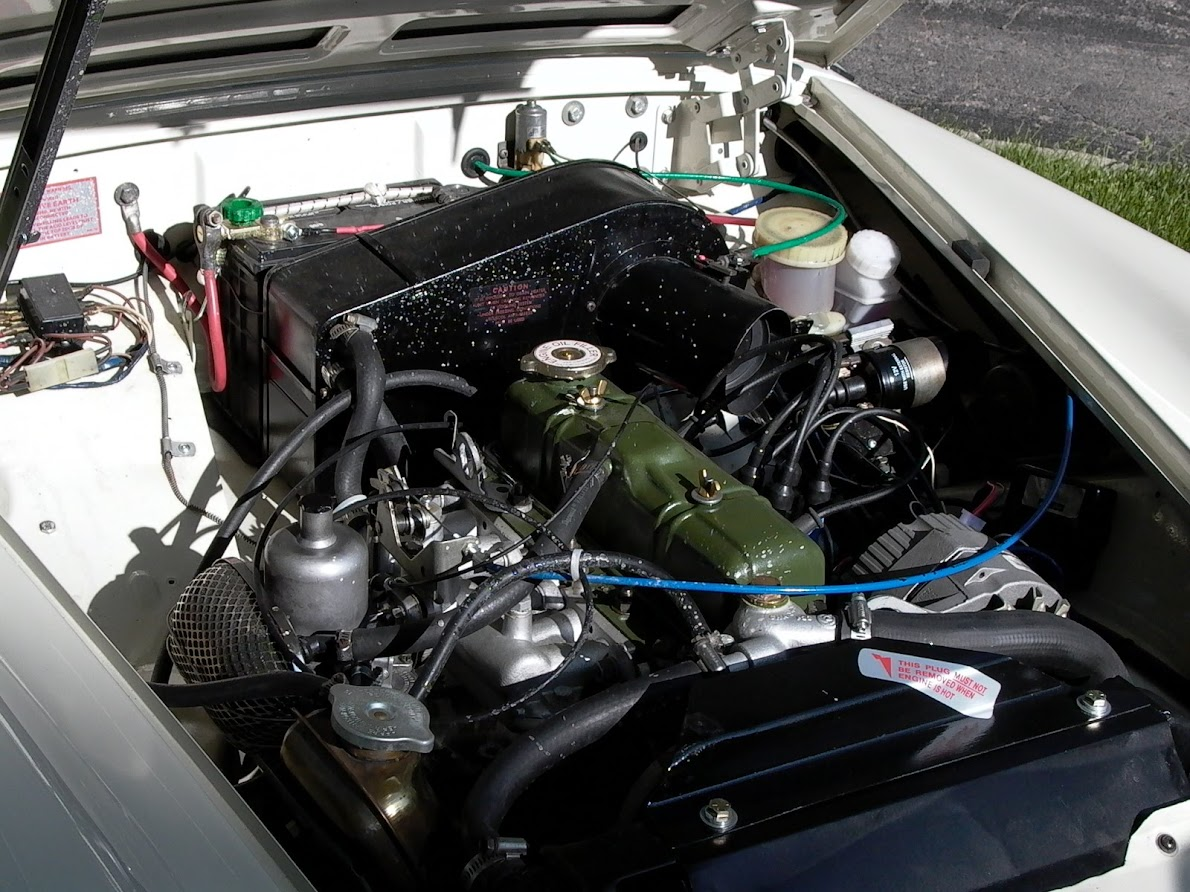

Engine is stock - except a delco alternator and an HS4 carb from an MGB. And of course two years ago I let significant smoke out of the wire harness - which is now mostly sorted.

Thanks - It is getting to the point where I need to be thinking of redoing some (it's been about 15 years - yikes!). Wiring on the top of the list and this year getting the mixture right. I have new rims that are about 2/3 refinished. There are various paint chips though I am not too worried about them.

When I pulled my spark plugs, I noticed far more carbon fouling on Cyl 1 & 2 than 3 & 4 (counting from the radiator back) which was showing signs of running lean. I leaned out the mixture on the front carb, increased the mixture on the rear carb and stumbled across a near perfect mixture. The car is running a little rich right now, but the balance between the two carbs is better than I've had it before.
excellent - I only have the one carb and I really need to take the time to adjust it properly (I know because it takes so much time to turn an SU nut a few flats :rolleyes2: ) I bought a new air filter unit at the end of the season as I suspect the old one is part of the problem. OTOH it is 32 deg - on April X#$%^28th! so, no rush I suppose. :mad:
