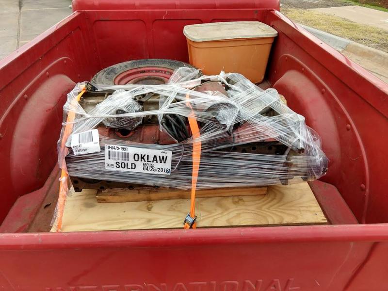

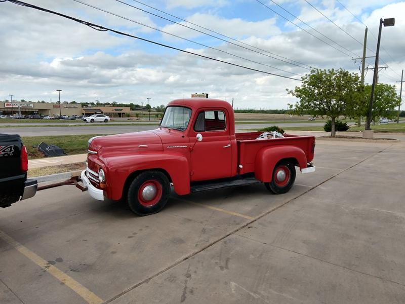

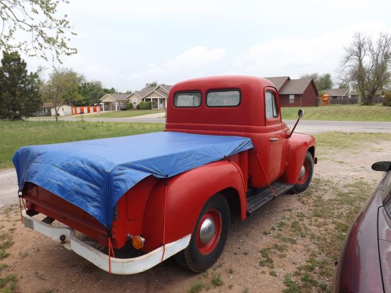

My old IH that has been in Lawton for the past fourteen years is at my house. In the bed it holds its new heart.

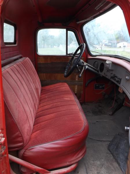

Please post photos of the engine bay, interior, dash, etc. Really enjoy seeing the old, simple, reliable, and "work-worn" iron.

This pick-up is my first car, I bought this when I was not quite fifteen and it is what prompted me to get my first job; that was twenty-three years ago. My father was told about this old pick-up by a cousin of ours who, at the time, was a local insurance agent. Our cousin's dad had owned the IH dealership around here and another agent he knew up around Kingfisher had just bought this pick-up off the original owner and thought my cousin would be interested in it. Needless to say my cousin didn't care but told my dad and gave him the couple of Polaroids he had been given of it. I asked my dad about it and he said that the $1500 asking price was too high and he wasn't interested in it. I told him I was but he wasn't going to loan me any money. I found a friend of my mom's who agreed to loan me the money on the condition I paid it back within a year. My dad coached me on how to haggle and we went to Kingfisher to meet the guy who had it. After a little negotiating I bought the pick-up for $1200. I had planned on mowing lawns to pay for it but stumbled into a job as a woodwind repairman at my local music store and managed to pay it off in three months.
The next year I saved up another $800 and had it painted by a guy my dad knew. I proudly drove it throughout high school and off to my first year of college. It developed a bit of funny feeling over the summer after my freshman year and I decided it might need a valve job. I pulled the head and on two cylinders it had broken out the upper compression rings due to carbon build up and had chewed up the exhaust valves. These were the #2 and 5 cylinders. The block looked okay so I set about rebuilding the engine. It took awhile to locate all the parts and I had them all ordered by the end of May. the summer dragged on without all of my parts arriving, September arrived and I drove my grandmother's old 79 Mercedes back to Stillwater for school. Some of the parts wouldn't make it to Lawton until the end of October.

A few weeks ago I located a short block. It had been in a running pick-up that the the PO had decided to put a Cummins in and had sold the engine to a guy in NY state. This guy only needed the head and decided to sell the rest. He wanted $500 for it I told him I only wanted the block and rotating assembly so he pulled everything else off and agreed to $400 for it. I picked it up from Fastenal, who freighted it, on Monday. If I can use the magic of the internet to locate everything I need to hope to have it on the road again in June, only seventeen years after it originally blew up.
Tom, I'll get some photos for you either this evening or later in the week if it's raining.

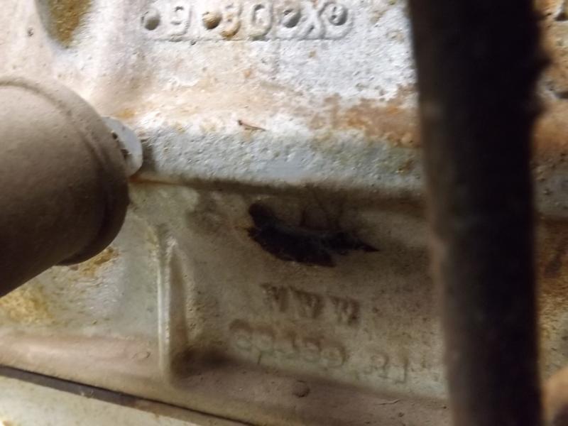

Okay, I may have been using hyperbole but I'll be sure to get a photo of the hole in the block.

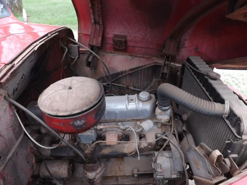

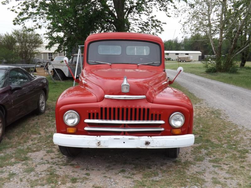

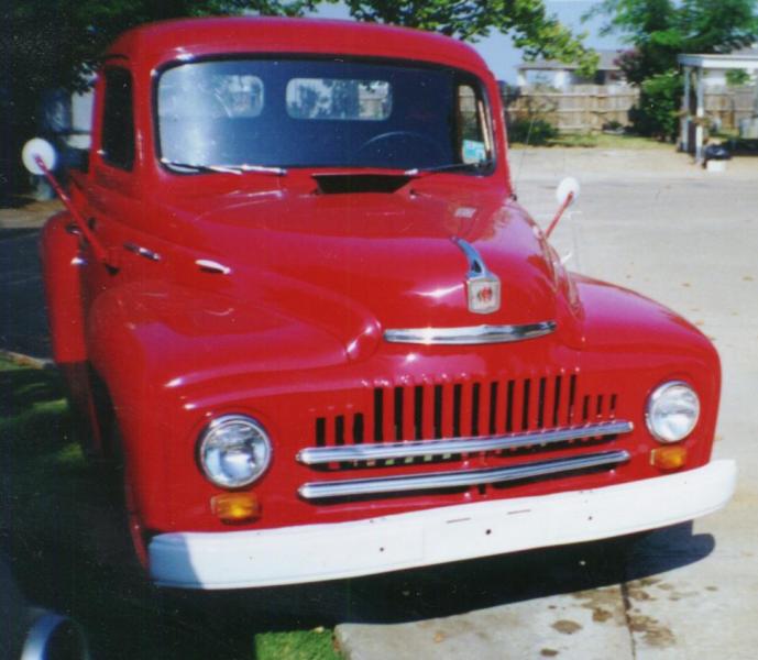

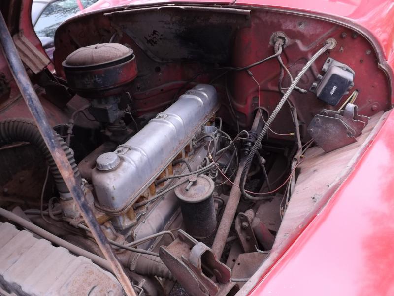

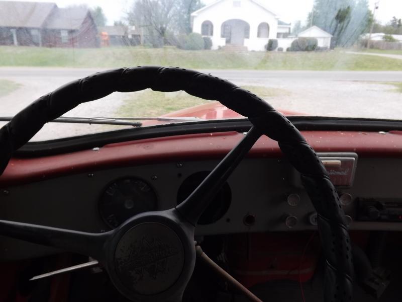

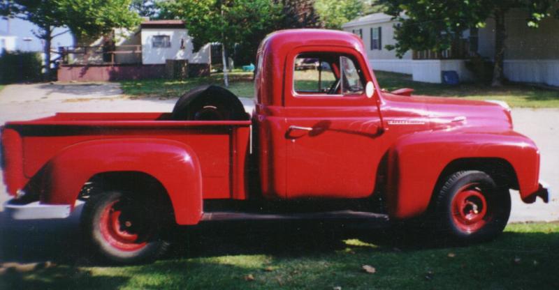

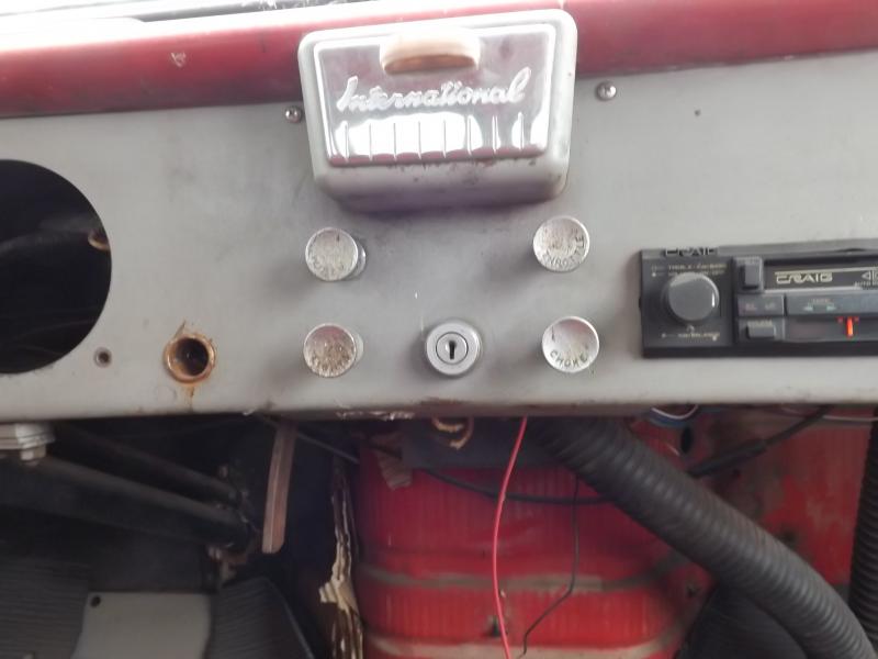

Here are the photos of the pick up. The speedo is out of it because I am sending it off to be rebuilt.
The engine bay, the last one shows the hole in the block.
These two are of what it looked like when I first got it painted back in 96.

Oh gee - that is a true classic. You are so lucky to have it and keep it original.
When I saw the clutch pedal, I thought "wow - a real truck!" yeehaa! When I saw the six in the engine bay, I remember how the six was the "standard" engine for most cars and trucks back then. Buicks and Cadillacs got the eights ... sorta. And that "spartan" dash panel with pull knobs. Fantastic.
