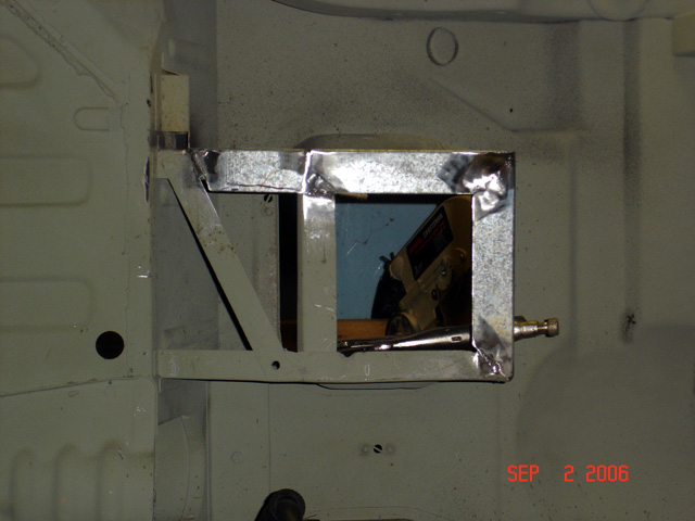

Wow, I was able to trim out all the bad metal from the driver’s side battery box, and fit up a new piece. Just a little fine trimming and I might actually be able to weld it in place tonight!

Driver's side fitted, trimmed, welded, and dressed. Just need to fill one screw hole (used screws to hold it in place, and clamped in weld area) I found after dressing and just a littel trimming.
Life would be so much better if I had an automatic welding helmet.
Now, need to tear out the passenger side box.

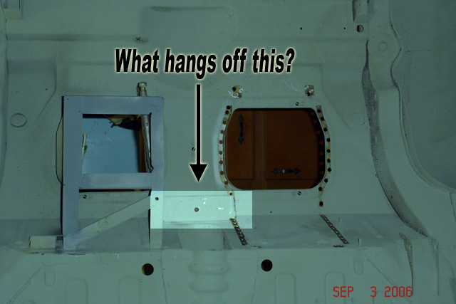

OK Guru's, what's the little metal box with a bolt up into it between the batter boxes? I took the bolt out expecting the box to be a cover plate for something, until I discovered it was spot welded in 3 places to the battery box.

I believe you are referring to the mount for the hand brake cable?

Re: WOW, I finally worked on my car!
OH...way back there? Hmmmmmm I will look next time I have the compressor running /ubbthreads/images/graemlins/confused.gif
I don't think anything hangs off it - I don't even remember seeing it before....going under one of mine tomorrow to see.....
It works out that the cross-over cable for the 2 batteries was held in place witha clamp here.
