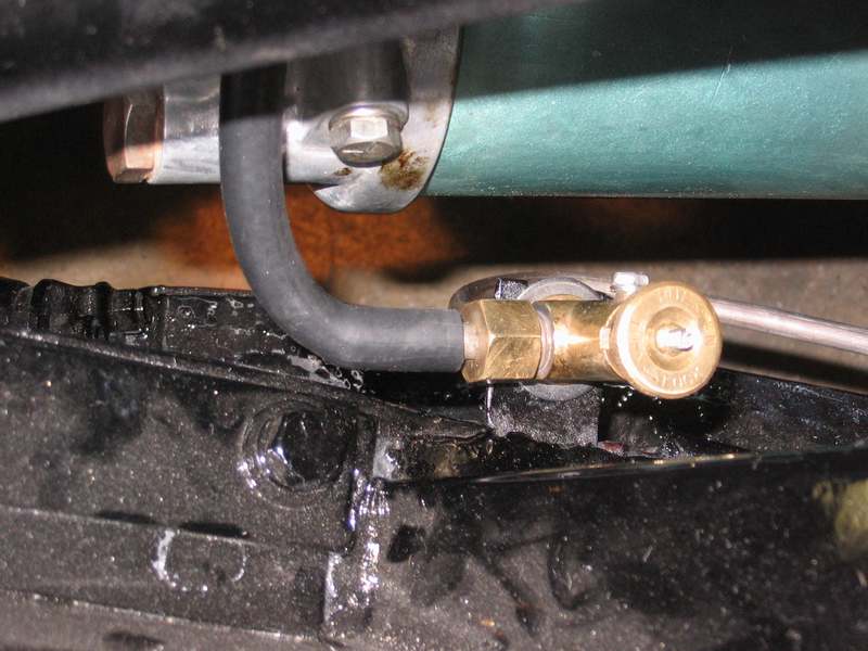

These little valves are available through industrial suppliers such as WW Grainger, etc.
Here's an example fitted to a TR3A.
