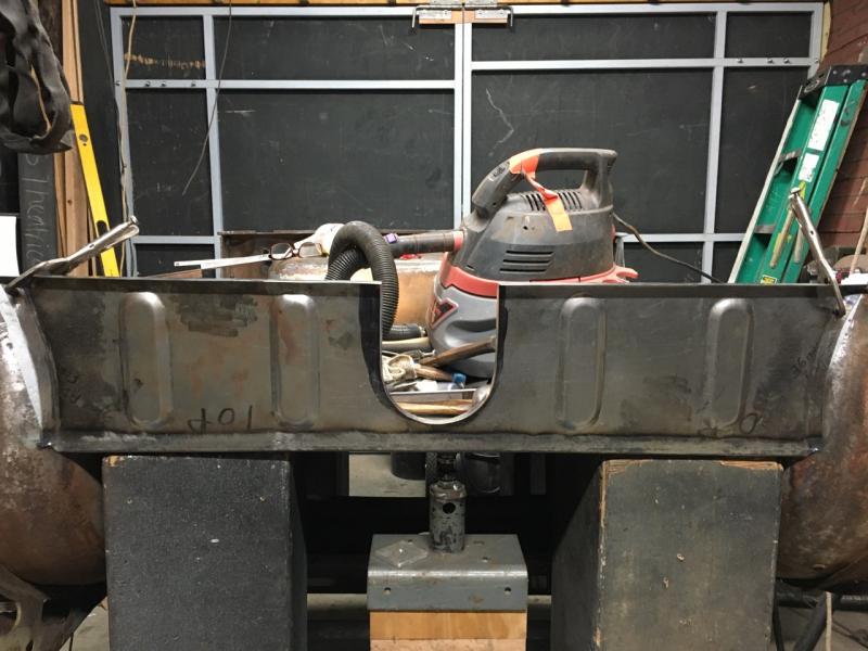

Front of mid section damage.jpg Front vertical panel damage. Started repair and decided to make new panel.
Front mid section vertical panel removed.jpgDamaged panel removed, Car is upside down.
Front mid section repair panel ready to tack.jpgnew hammer formed panel ready to be tacked.
Front mid section repair panel tacked.jpgnew panel tacked ready to be welded.
Front mid section repair panel welded and finished.jpgnew panel welded and weld finished.

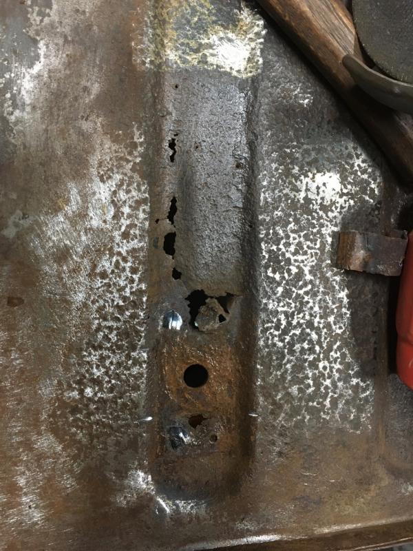

On to the front fuel tank support and nuts for the fuel tank straps.

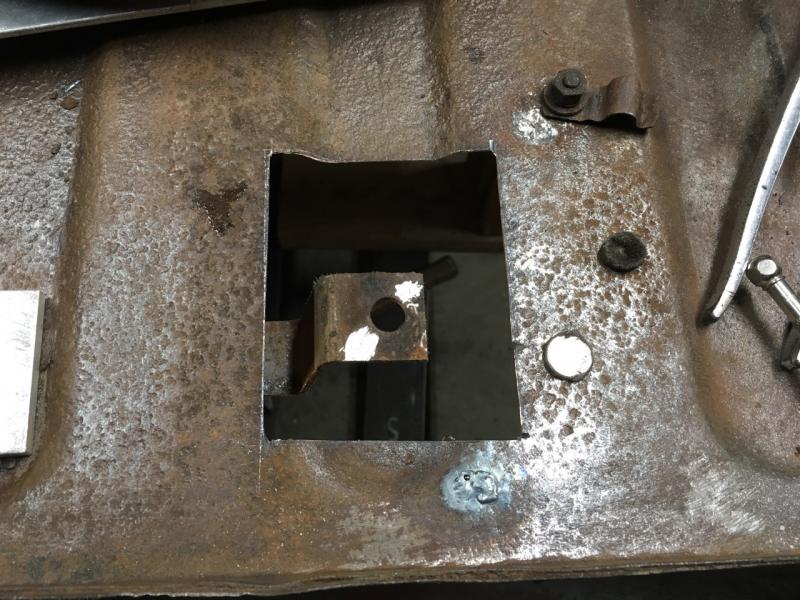

new boot floor.jpgThis shows the damage where the fuel tank support weld to the floor. the square blocks the driver side damage.

Driver side fuel tank support repair.jpg Driver side floor repair, damaged area removed.

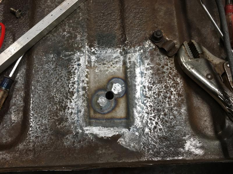

Driver side fuel tank floor repair.jpg Driver side floor repaired and welded to fuel tank support.

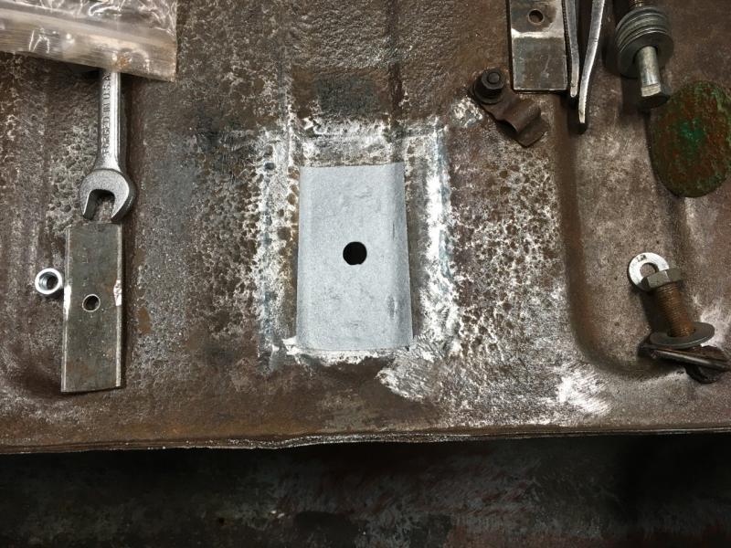

Driver side floor repair zink primer.jpg Repaired area zink primed before reinforcement welded.

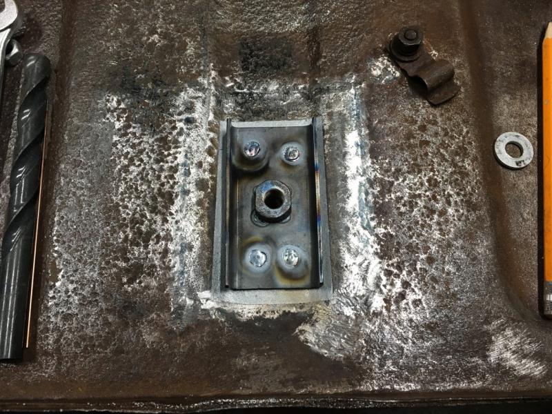

Driver side front fuel tank reinfocement.jpg New reinforcement with original crimp nut, Good as new. Process is same for passenger side.

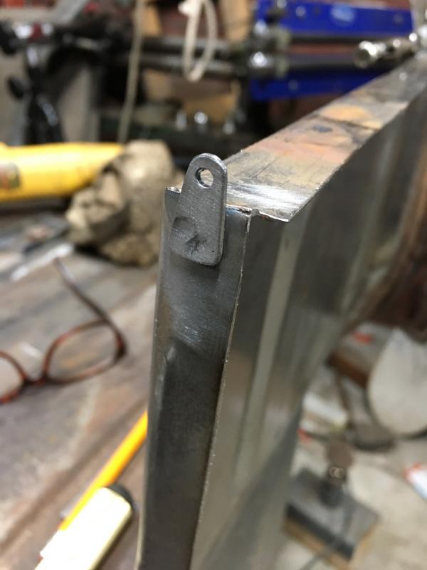

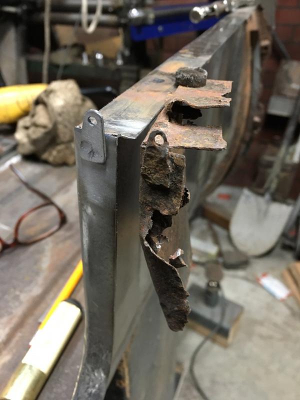

anti rattle tab ready to spot weld.jpg Anti rattle spring tab ready to be spot welded.
new anti rattle spring tab.jpg Anti rattle spring tab spot welded in place.
anti rattle spring tab new and old.jpg New and old anti rattle spring tab.

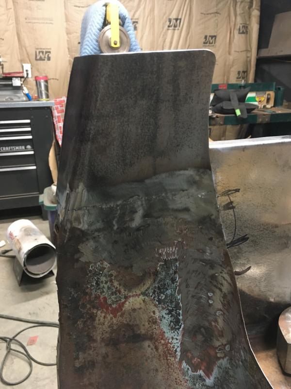

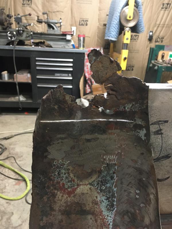

Passenger inner wing with damage.jpgBottom of the rear inner wing.
Passenger rear inner wing after repair.jpgrear inner wing after repair
There was not much left of the bottom of the inner wings. sheetmetal patches sealed with tar and pop rivets is the kind of stuff that makes me shake my head but I guess the PO did the best he could. I am looking forward to transitioning back to the front and continue work on that . Frank

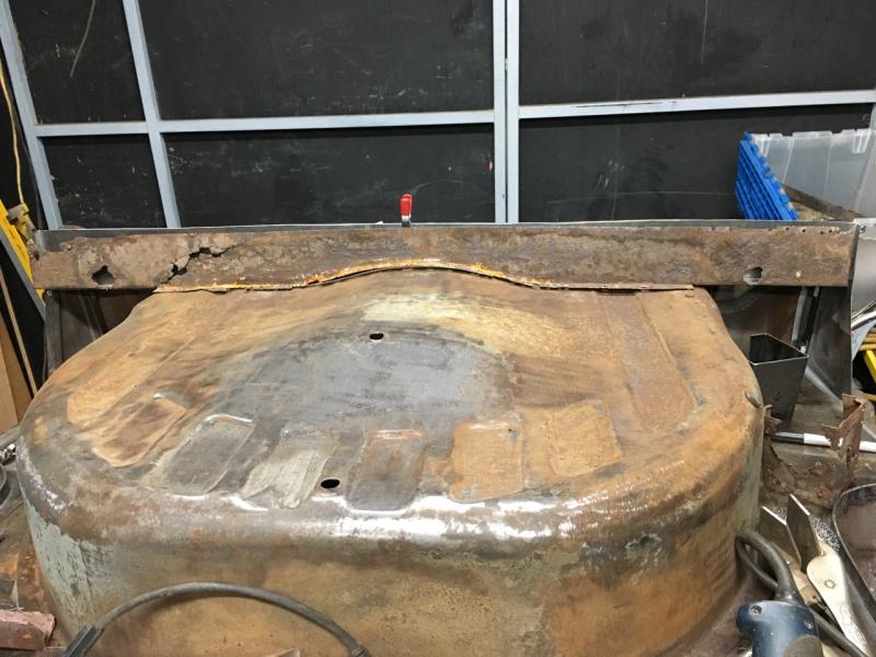

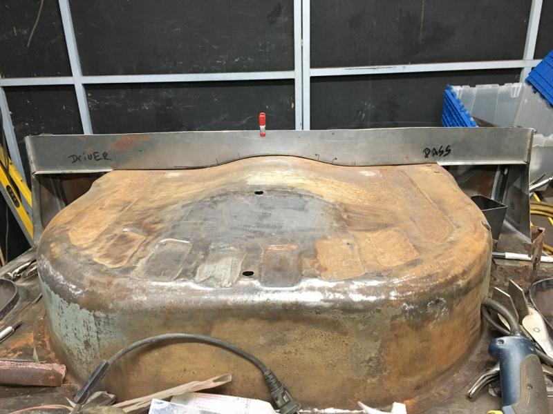

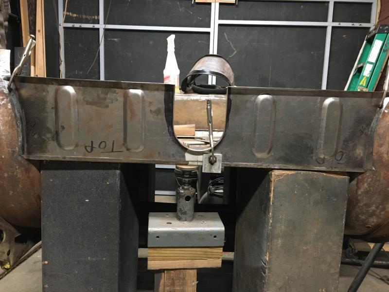

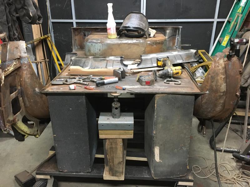

Pretty cold in the shop last few days so not a lot of progress. The sheetmetal parts are the last to warm up so hands don't warm up either. These closing panels were made a few months ago and just now getting to start final fitting.
original lower rear closing panel.jpgoriginal lower rear closing panel.

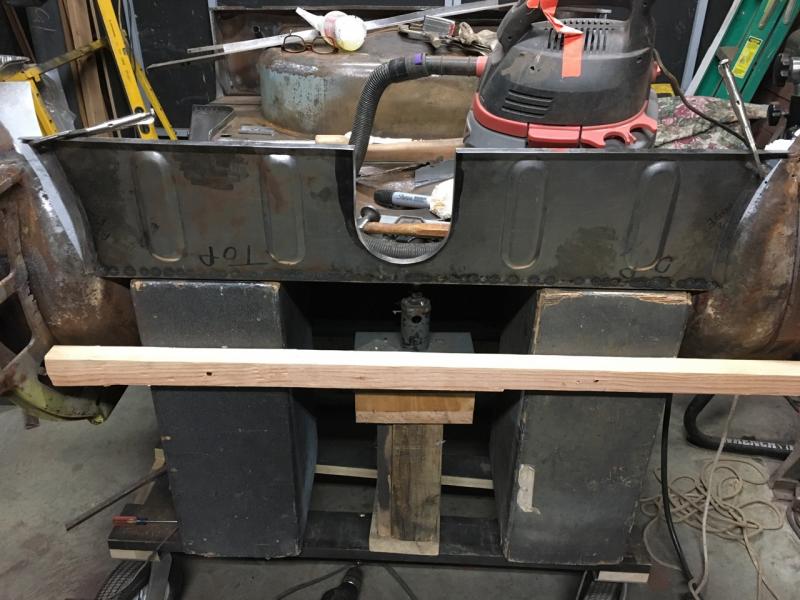

lower closing panel form.jpgHammer form for the lower rear closing panel. I made a template that matched the spare tire pan. used it to make a hammer form out of a piece of oak from an old shipping pallet.
lower closing panel flanges formed.jpg clamp the sheet metal to the hammer form and start forming the flanges. The curved flange takes a little time as that flange has to be shrunk as it is formed. The 90 degree flanges are pretty easy , you have to pay attention on this panel because flanges go in different directions so it is marked on the hammer form so I don't get confused.

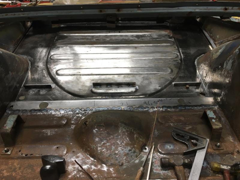

lower closing panel fitted.jpglower rear closing panel in place. I am very happy with this panel as it fits the spare tire pan and is under no stress to hold it in place. Once the closing panels are all fitted this will have to wait so the inside of this area can be sand blasted and primed before all the panels are spot welded, closing in this area for ever and ever. Frank
