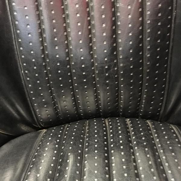

Hi All,
It depends upon the degree of lumbar support you are looking for. The Healey's seats, in standard form, don't have even a hint of lumbar support and I found this condition quite uncomfortable on even local runs. As I got older, this condition became intolerable and, even though I did not want to use an additional lumbar pillow, I seriously considered doing so.
My solution was to unhook the bottom of the seat backs and place additional padding behind the covers. This allowed enough lumbar support (for me) and still retaining the look of a nicely padded original seat. There is, however, a limit to the amount of added padding the seat back will except before it starts to look uncomely and exaggerated, however, I had installed this padding over 15 years ago and those who noticed were most complimentary to its look and sitting feel.
Original Covers
Just my approach,
Ray(64BJ8P1)
