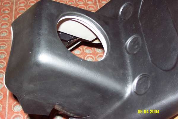

I went around with Moss on the flared center hole. They acted as if there's no such thing. I even sent photos when my cover didn't fit "down" over the flare to show them - btw, the flare is in the aluminum. Never heard back from Moss.
My fix was to used a large sanding drum and cut back the outside of the flare enough for the cover to fit. It came out OK but would have been better with a little more vendor support.
I'l hunt for the photos I sent and then edit them in this post.

The lip kept the center of the cover up and prevented it from fiting down snuggly over the console. Note the aluminum showing at the bottom of the shifter surround.

Scott, Peter answered your question. My car has the flared support and my guess is your's will too since the Comm #'s are so close. Interesting that all they need to do is make the cover with a little more material and maybe it would work for both styles. At least that's what Peter's post would seem to indicate.
PeterK
I think that there is only one outfit that supplies these covers to all vendors. My mods worked but I surely would have liked it to fit "as advertised" or at the very least, Moss could have acknowledged the difference and not treated me like I was the one that was at fault.
Anyway, dry fit first and line up the switch indentations, etc before final gluing.
Comm# is CT66715L
