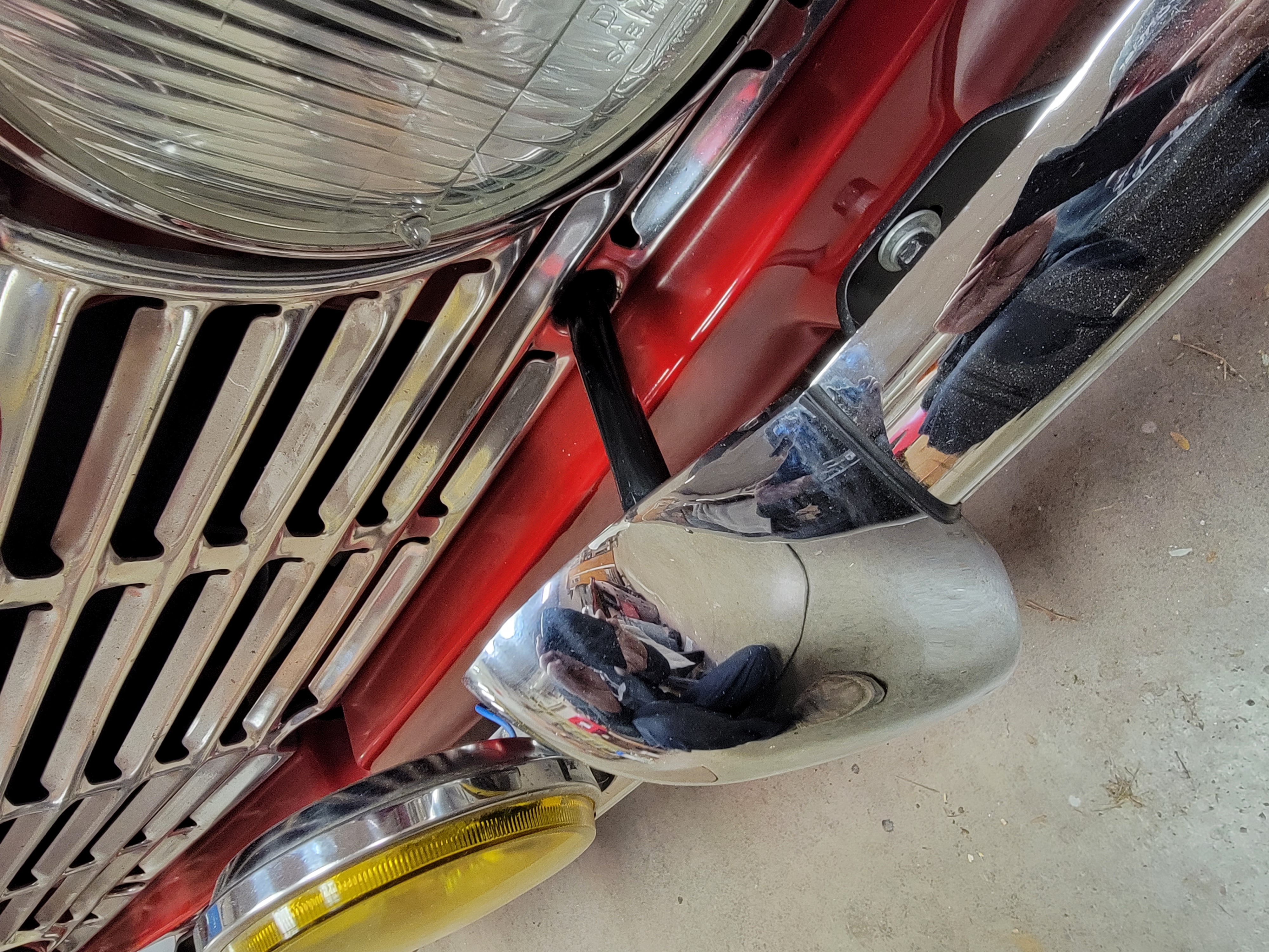

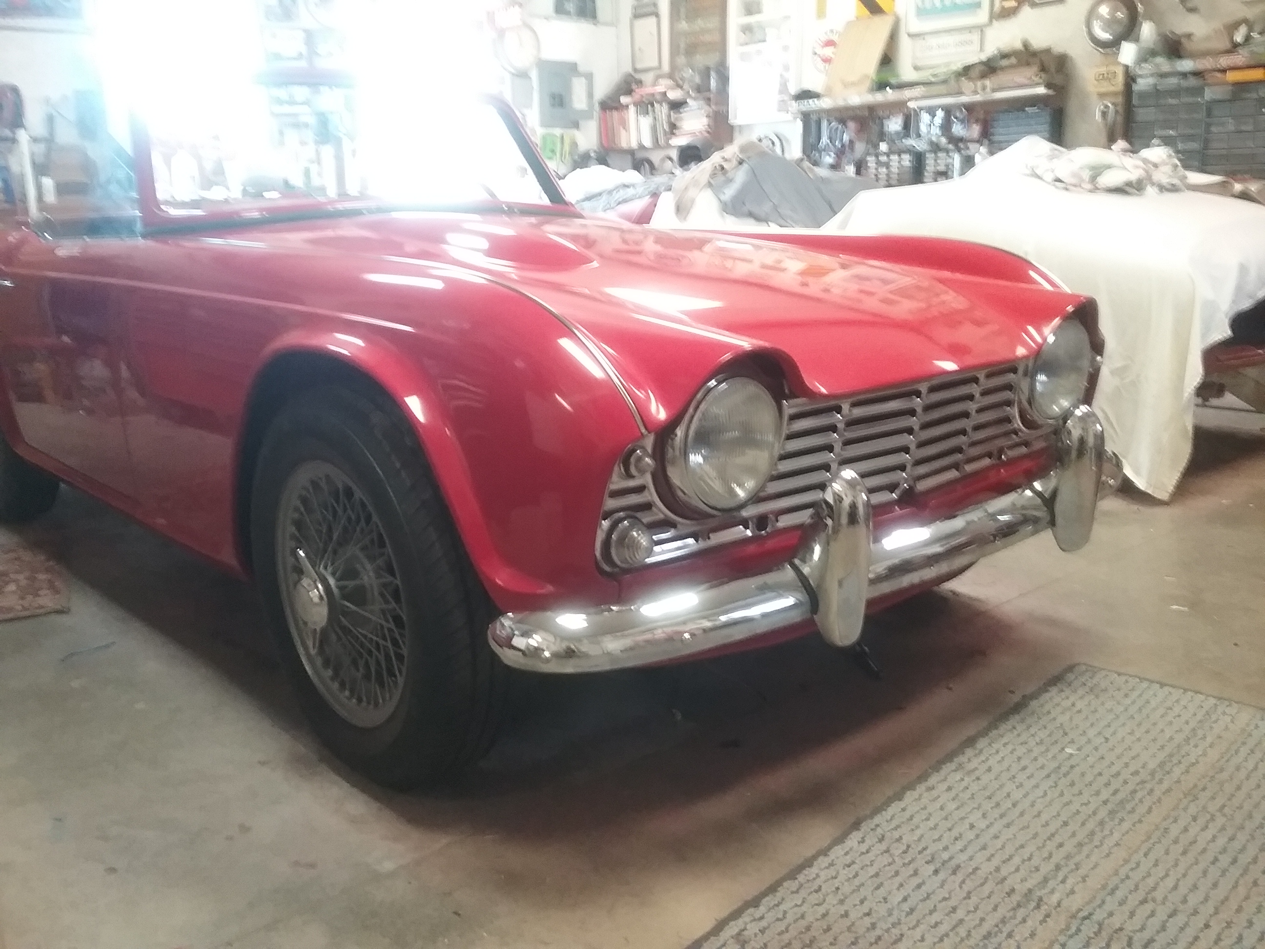

Does anybody know the correct diameter of the front overrider supports? Also, chromed or painted? Just to be clear I am talking about the bar that goes from the front overrider back through the hole in the grille. Looks like maybe the bar is is 5/8 or 3/4 O.D. Want to make my own.

They are supposed to be there but rarely are. TR4 only. There is a threaded hole in the back of the overrider and a slotted hole on the inner fender. Moss P.N. 804-070 & 080. I just don't want to pay $120 for 2 plain steel bars.

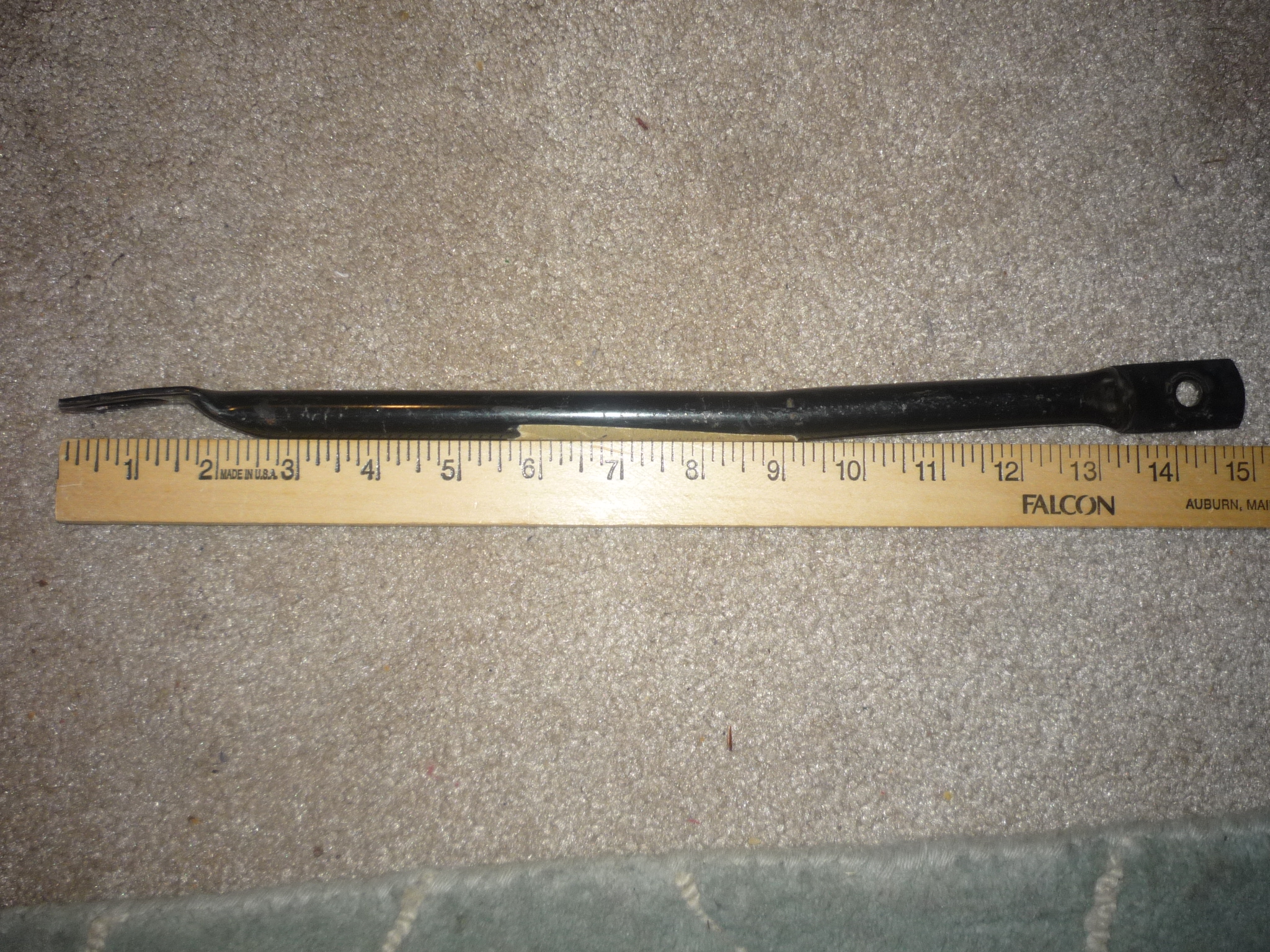

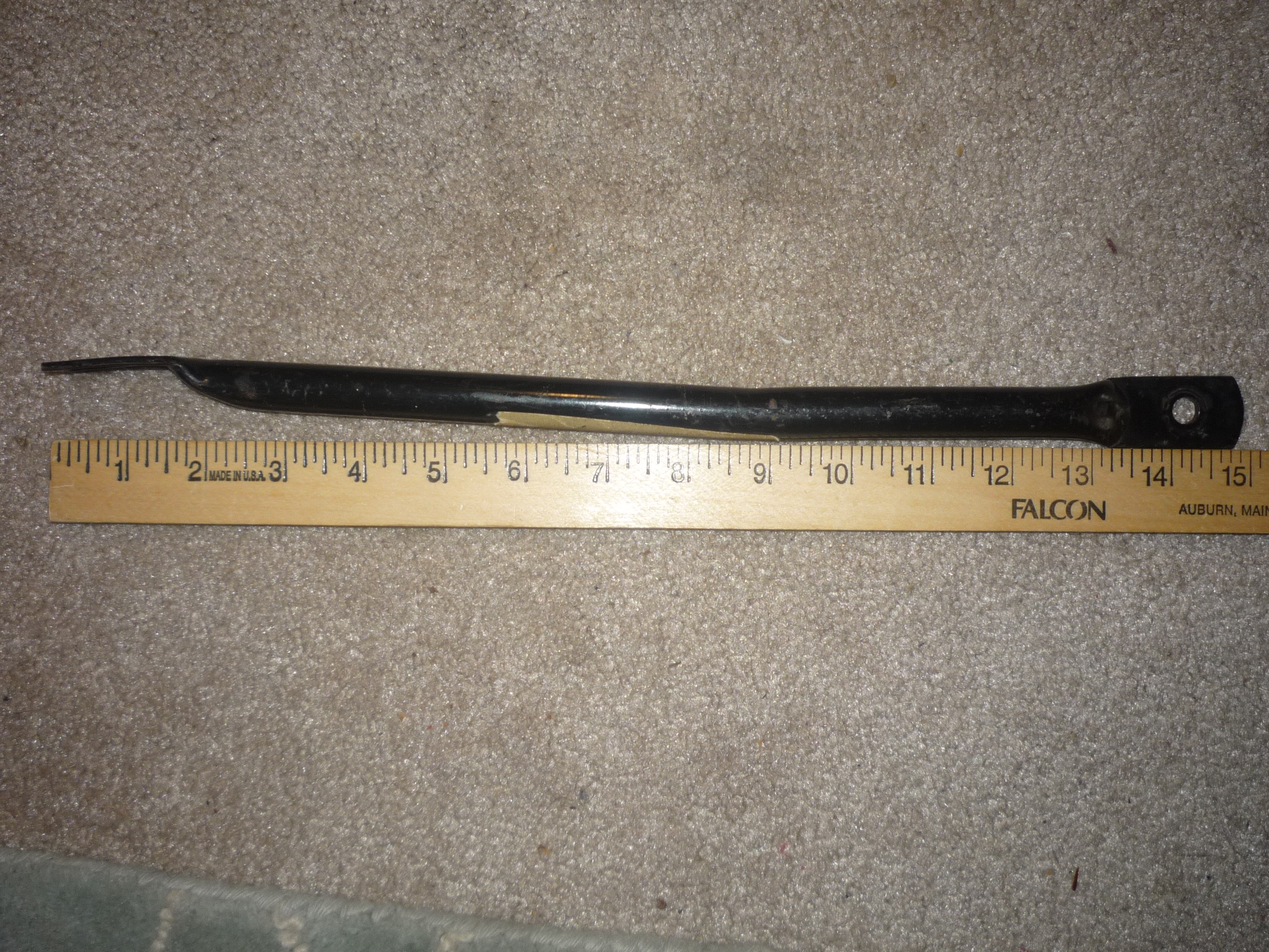

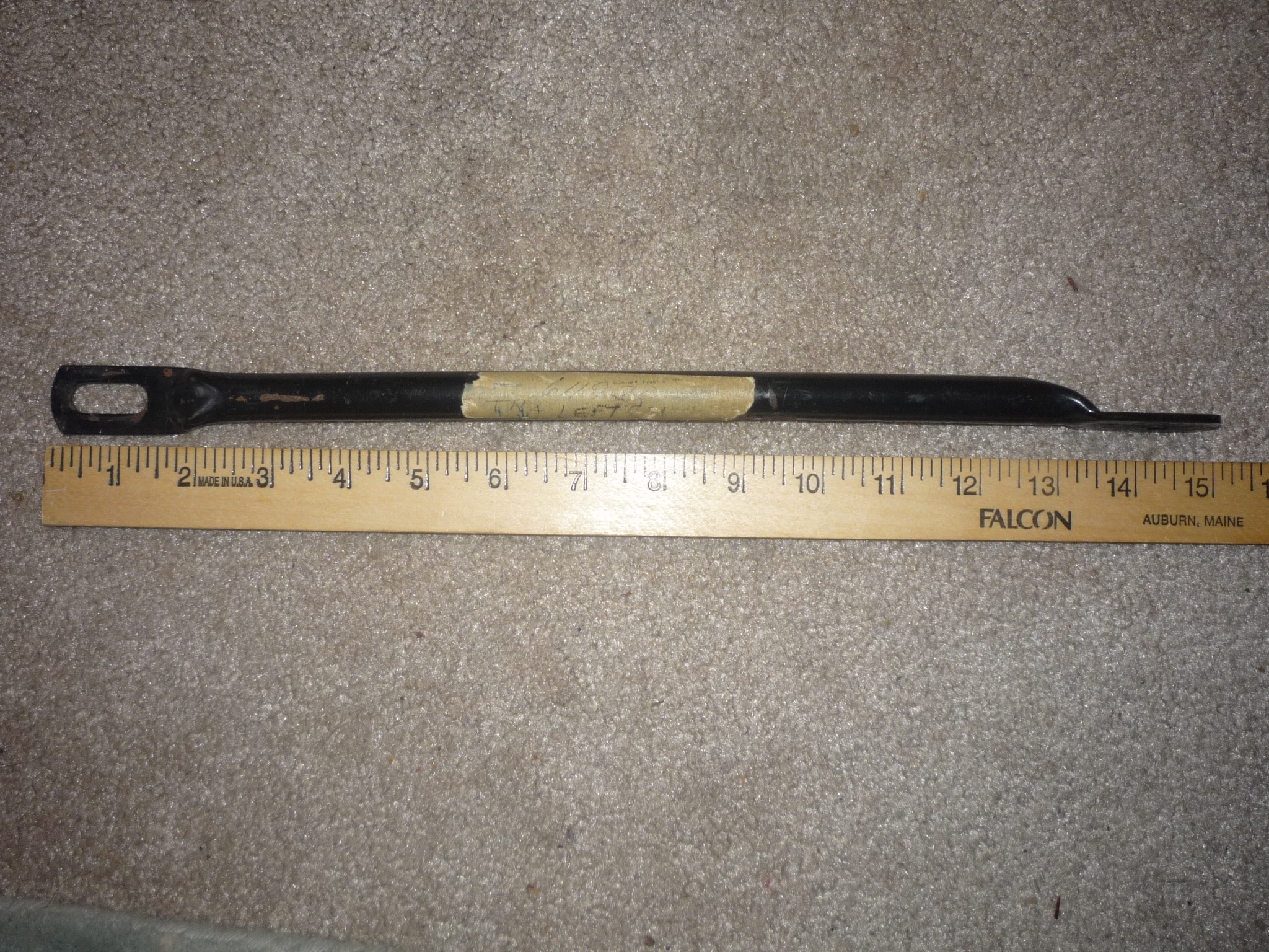

Hi Larry, I have a stash of parts for the eventual restoration of my old college TR4 and have a left-side overrider support, PN 611970. It's 15" long, 5/8 OD from 1/16" tubing. Painted gloss black, 15" long with a very slight bend at ~9" from the slotted end. The car is stored in another state so can't confirm how it goes in. Jeff
