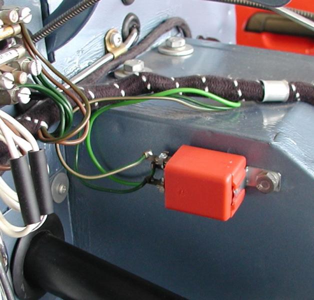

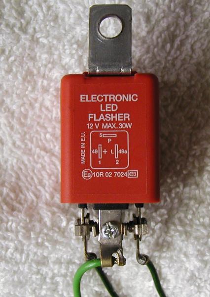

Joe,
I decided I needed LED lighting, but did not want to add resistors (More complexity, heat, and connections) to the circuits. I went with the electronic LED flasher which works perfectly, see below.
Thanks,
Duane
Joe Schlosser
Joe Schlosser
Thanks for the info. I am guessing we will go with the LED flasher.
