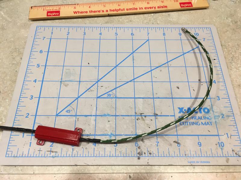

I was able to "fix" my problem. I went the route of adding resistors, the ones suggested by Randall. I used one resistor for each location, a total of four. I painted them with a red (to match the body work) high-heat enamel and epoxied small neodymium magnets to hold them. I replaced the wiring off each with the correct color-coded wire (GW, GR and black) and plugged them in. Using my stock flasher, they worked like a charm. While the electronic flasher was fun to do (disguising it in the original body), I would have had to capacitors to overcome the electrical noise. Adding resistors seemed like a better solution, plus they're more easily hidden.

Brilliant solutions: the color-coded wiring, the magnets, and using the extra bullet hole to connect in! Thanks —
