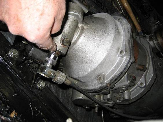

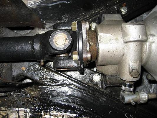

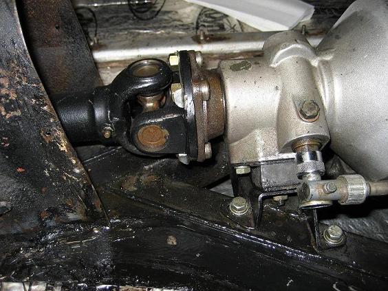

OK, I'm totally ignorant in all of this. I removed the tunnel cover, because fluid had been leaking out from under the cover. I've attached pictures. Where my finger is pointing, it is a very loose connection, it shifts back and forth about a half inch - maybe a little less. There is a seal in this system, could it be that - I can see no sign of the leak, just a puddle of fluid. Help!? :eeek:

Hi, That is the speedometer angle drive it should not have that kind of free play. I do not see the knurled cap that attaches it to the speedometer spindle assembly, hats the thing you have your finger on. The fitting I am referring to is very similar to that knurled cap that attaches the speedometer cable to that fitting. OK I see it in the last photo so the retaining set screw by your thumb is probably misadjusted---Keoke

Thanks, Keoke - would this cause the leak? Just release it, reset and tighten?
Probably but there is suppose to be a swaling washer on top of the main body be sure its there,
Just release it, reset and tighten? Ywah do this first and see if the leak does not stop.---Keoke

if still leaking, there is also a special copper washer that goes under the knurled cap - it is often missing.
