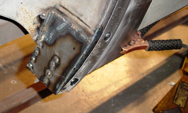

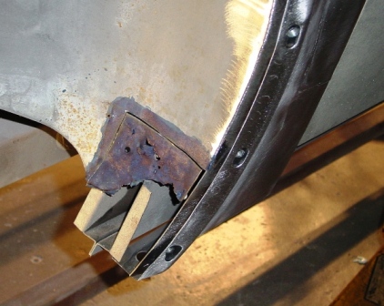

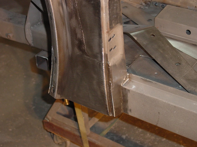

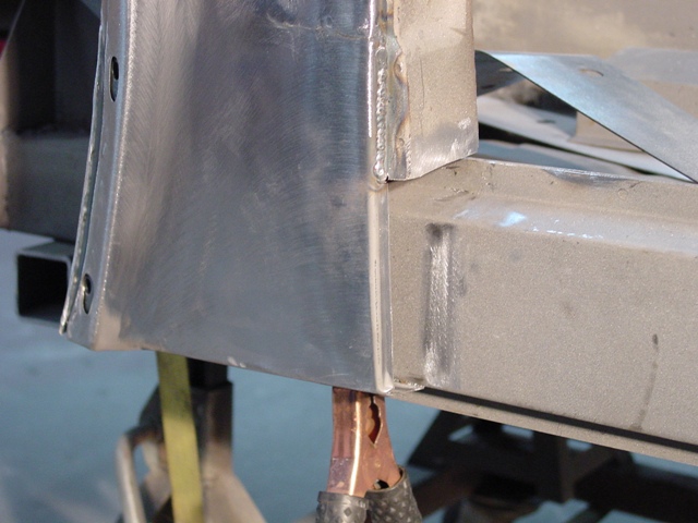

Randy, this is a notorious place for rot, so your suspicion is well placed. perhaps these before and after photos will help

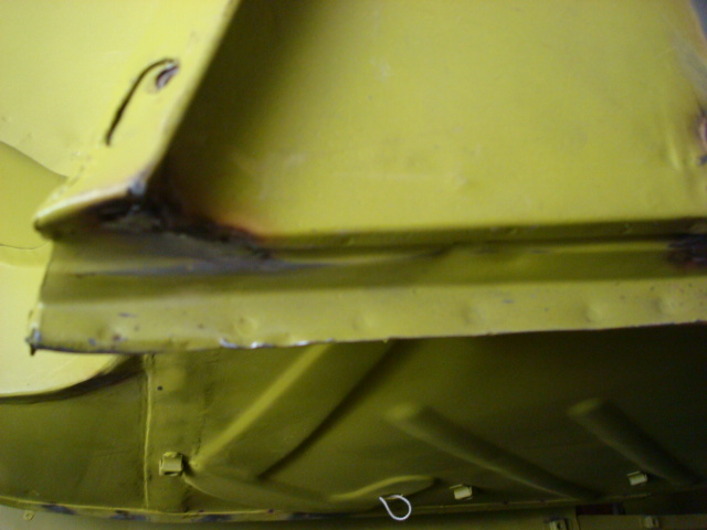

mallard
This is what the area looks like on my late 1957. You should be able to see the overlap of the outside body shell, a small grove, the spot welds. and a drain hole near the back. This area is almost rust free on my car,but you can see an area of weld repair. My guess is that you are looking at a bunch of bondo (MHO).These cars had a ton of spot welds, look for them.
