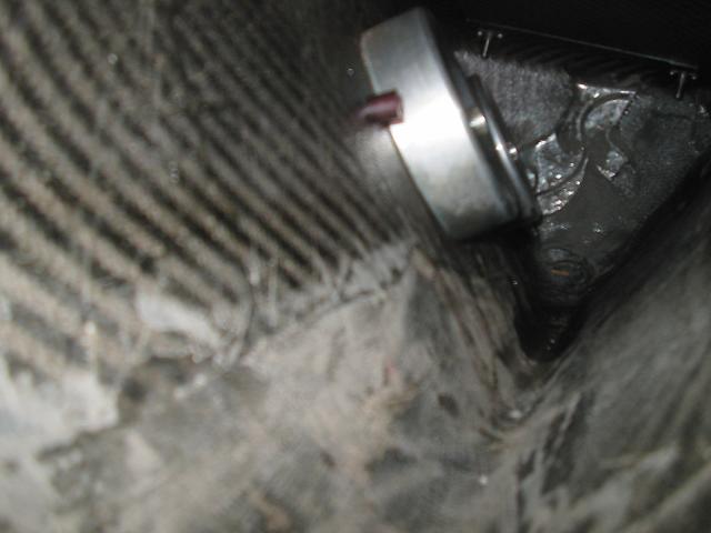

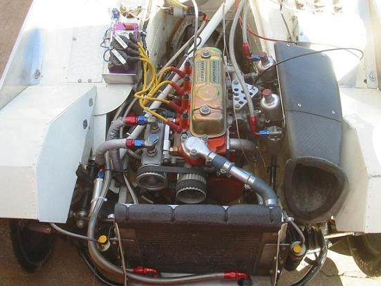

If you run a completely sealed cold air box you have to vent the vent tubes from the SUs directly into the cold air box as well to equalize the pressures. Look at the picture inside the cold air box on the race car I drove a few seasons back the tube you see sticking thru the cold air just beside the velosity stack is a tube running from the float bowl vent into the cold air box, the second picture is the cold air box from the outside view, when the nose of the Bugeye was close shut, a section attached to nose clamshells the entire unit closed and it takes in air from one of the headlight openings. I don't recommend cold air boxes for street cars, makes them too hard to work on.

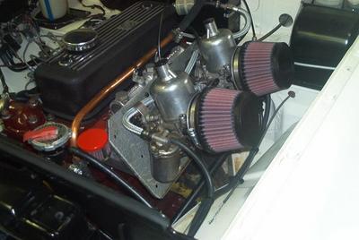

Here's another K&N filer application on a MGB, that is simple and better flowing than most offered in the marketplace. I made a simple mod to the factory filter bases, by counter boring them and using sockethead allen fastners, but you can achieve the same thing without the counter boring by using button head fastners, then use a K&N unversal cone filter that slip over the OD of the factory filter base and then clamps to hold it in place. This set up has no fastners passing thru the inside of filter assembly and allows for better flow. Another bonus is it is simple to remove, loosen the clamp and simply pull the filter out of your way.

Hap, where'd ya get that cold air box?
RickB
Looks like something custom made. I've seen things made of material very much like that. If it's an 'off the shelf' piece I could imagine a bunch of people wanting one.

I like that set up HAP. Simple.

Tony, that was on the Huffaker Bugeye race car, it was a custom carbon fiber unit, mucho bucks. Funny thing is that Huffaker did alot of on-track, on board dyno testing with cold air boxes and never saw any real gains with on anything other than the 948s with cold air boxes, and those are the only SU carb cars he ever used them on after his testing, his set up for the 1275 SCCA FP cars, which use HS4s (MGB carbs) used a K&N filter set up simular to the one I have on my street MGB pictured above. The above K&N air filter set up I used on my street MGB is something we racers have been doing for awhile, I just adapted it for my street car.

Many of a racer have done a cold air box on a race car, and I'm sure had some minute gains, the thing about cold air boxes is that you can't test them easily, a engine or chassis dyno can't test their effectiveness, so a elaborate on board system is all you have to work with, and even in racing very few have went this route, Huffaker being one of the few. Here's the bottom line, if you do a cold air box right, it's a cumbersome set up and makes working on the car even harder than it is stock, so for me, I want a gain in air delivery and I want it simple, so I don't mind working on it, and it doesn't get any simplier than what I did with the cone K&N air filter, I do the same thing with my race car, and I have a prottype cold air box I had custom made form hi impact plastic, new hangin on the shelf for a 1275, I doubt anyone would ever buy it form me, because it cost a pretty penny to make to begin with.
