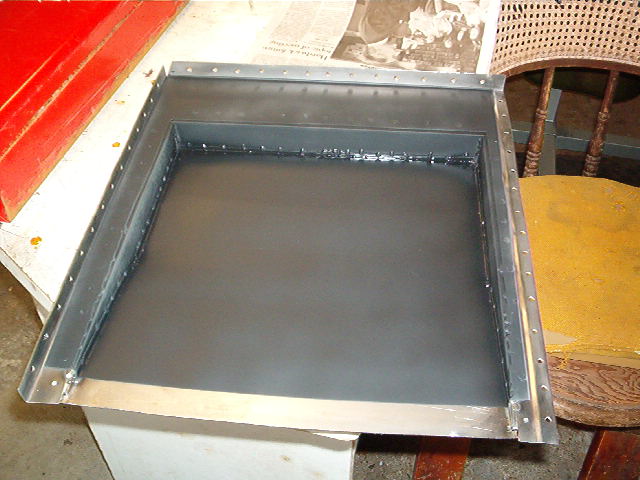

FWIW, I added about 3/4" of legroom in my '71 by fabricating my own floorpan with 1 1/2" of depression instead of the stock 3/4". I'm 6'4" and maybe it's all in my head, but it feels like an improvement.
