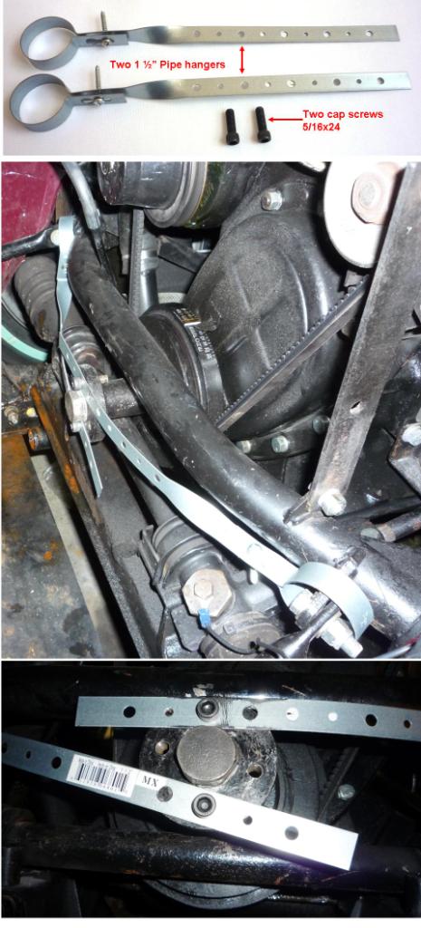

I'm preparing for the supercharger installation and I need to remove this. I know I'm not doing it right. When I turn the nut it just spins. How am I supposed to remove it?
Gliderman8
Here's how I did mine...
So.....what model is that? When did they come up with reverse rotation? The way it's hooked up, rotating CW as you look at it, those straps will fold up into pretzels when you put a wrench on it....

Gliderman8
TOC said:
He did want to remove it... right? Turn it CCW and it works; reverse straps and you can tighten it. Other suggestions will work too.
