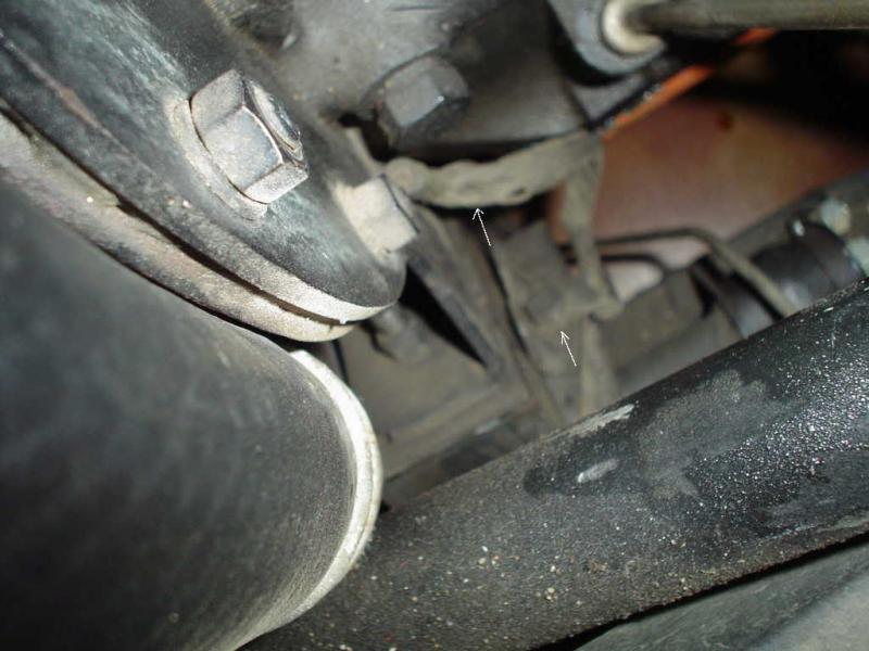

This picture is not the best, but it is the stock grounding cable

John suggestion about a poor ground because of paint sounds good and needs to be confirmed. Maybe your ground strap needs to have some paint removed on the ends. Perhaps there are 2 problems a weak connection with the starter somewhere in that circuit and the starter itself needs brushes or an armature or something. Was the starter rebuilt? Is the starter a stock one or a new high torque model? There are 2 high torque starter models for triumph 2,3,4. The only difference is the amount of teeth on the starter gear, and that is only one tooth difference. I am not exactly sure, but I think the early triumph used a 10 tooth and the later 11.
