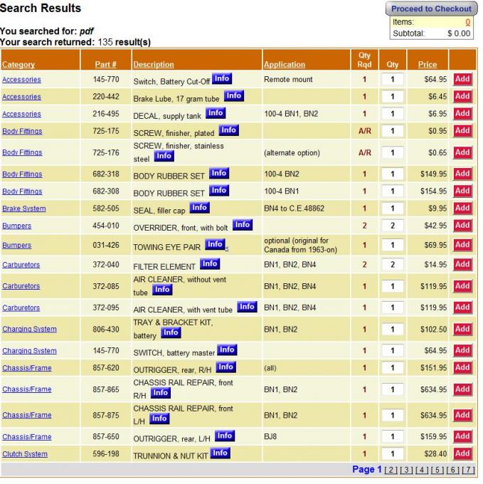

Yes, Moss has a little blue "info" button on the list of parts. Clicking on it loads the additional information on the indivdual part.
