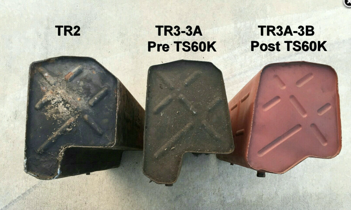

A pic or 2 would help diagnose what's going on. It could be the right tank with improper repair on the boot floor, or it may just be the wrong tank. The tanks I know of:
1) The TR2 12 gallon tank that went on a sloped rear deck body.
2) The early TR3 tank that changed to 15 gallons and was used on the sloped deck body.
3) The post 60k tank that was 15 gallons and used on the vertical rear deck body.
There is a 4th tank that fit into this mess somewhere along the line. All 4 tanks use specific mounting straps.
ckeithjordan
From the Macy's Garage website:
