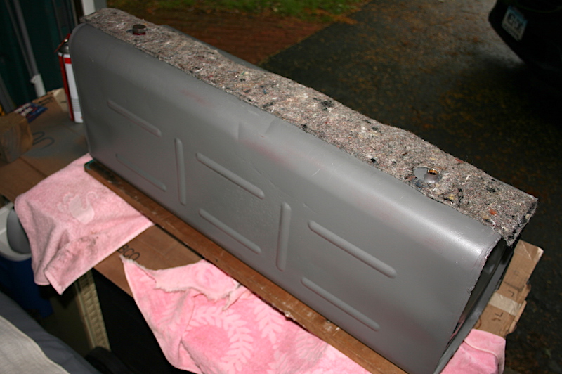

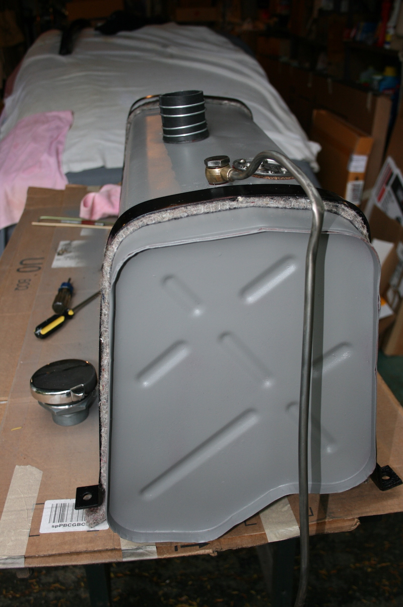

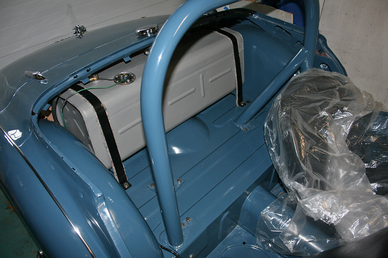

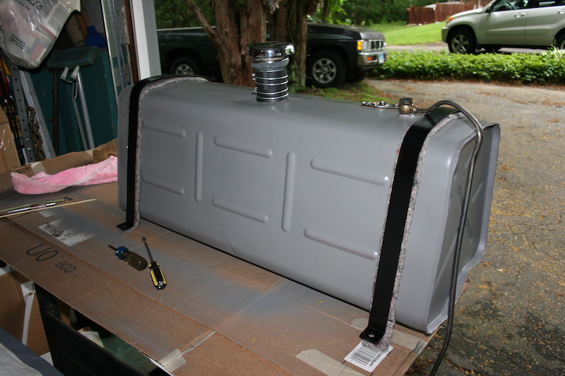

Bruce,
Not a TR4 gas tank but...I have attached some photos of my 1961 TR3A tank that I did a few years ago. Showing the felt strips and the felt on the bottom of the tank. hope that might help.
Colin
