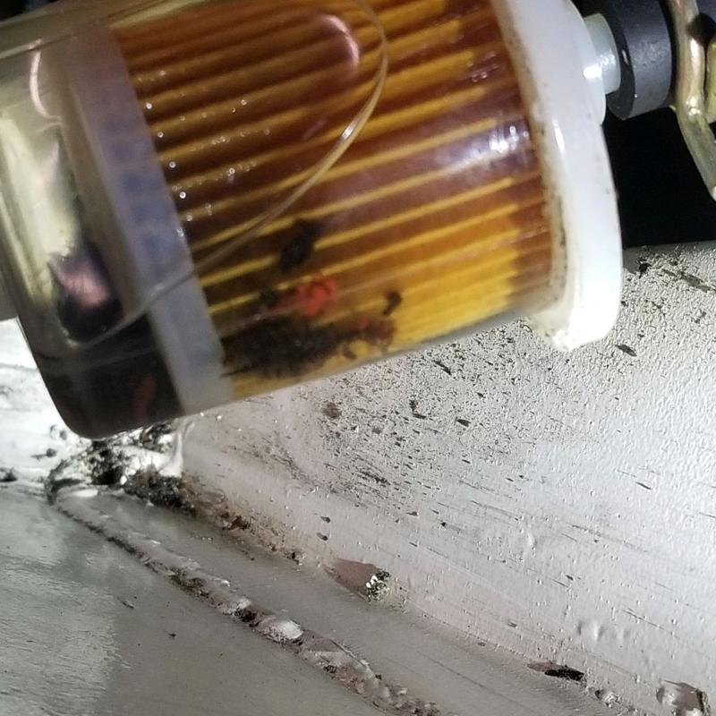

DavidApp
+ 1 on Marx-5 comment.
This is my filter before the pump. I have driven about 1500 miles and this is what was collected by the filter.
The tank was clean and had been empty for 25+ years before I used it. Also all new lines.
David

cityslicks
David did your line have a gooseneck as well? Based on all the replies a gas filter is a given regardless of the shape of the line Thanks to all for the info.
