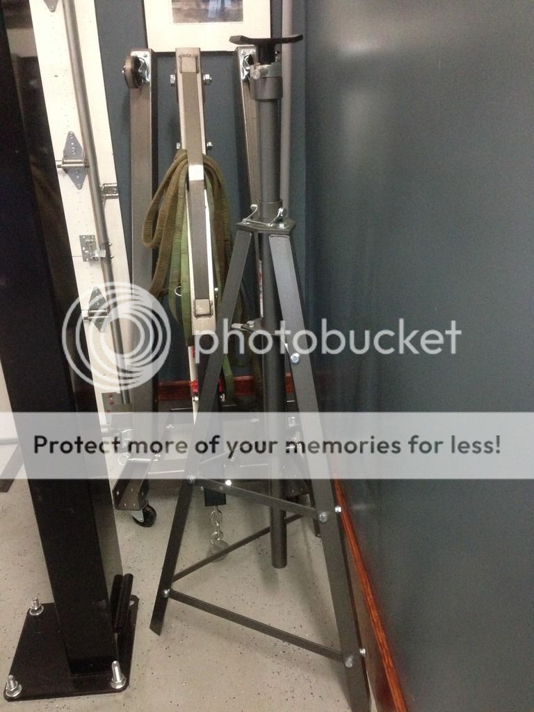

Big fan of the two part epoxy floor here. Mine has been down more than 10 years and appears as it did when installed. Clean ups are a breeze and there is no staining. If the grease gun drops a dollop of grease...no big deal. If the main seal burps a bit of oil...so what. Afraid of carrying a pan of antifreeze for fear of sloshing some on the floor?...won't matter if you do, it won't seep in. Want to use a spray tire dressing?...any overspray cleans with a paper towel. A weekly pass with the dust mop and it looks beautiful (no concrete dust). A springtime bucket and mop patrol with Spic N Span and it's back as new.
JPSmit
How scratch and scrape resistant is it? Not just jack stands but heavy axles etc?
3798j
Bronze
It's more scratch resistant than concrete. This engine stand's metal wheels will leave marks on concrete. It doesn't leave marks on the epoxy. Can it be scratched or scraped yes...but you've gotta make an effort. A dropped 10" adjustable from the workbench isn't going to mark it.

In terms of floor covering, I am firmly in the epoxy camp. Two-part 100% epoxy, not the water-based stuff at your favorite box store (I have painted two garages, using Benjamin Moore and PPG). To answer JP's question, I find it does scratch easily but still looks great. The floor starts out glossy and becomes matte over time. (I have a uniform gray paint, no anti-slip additive.) I drag jacks, jackstands and other heavy tools across it, each creating small scratches.
Given your garage has a wood floor, it might require less preparation? The wood would not need to be etched, and perhaps oils soak deeper into the wood and stains do not need to be removed to get the epoxy to stick? Application is a bit tricky, as once you mix the paint, you have about 15 minutes to get it on the floor. (Pour the entire batch of mixed paint on the floor, squeegee it out, roll once to get it smooth, and walk away - any more touching and you will see it when finished.)
Having said all this, I like the mats. Easy-peasy to install. Obviously you can't weld on them without additional protection - but the wood floor kinda makes that a moot point. My one concern: how hard is it to roll stuff over the grooves (a creeper, rolling stool, or rolling table, etc.)? (How deep are the grooves?)
Bottom line, my opinion is to cover the floor. Finding a dropped rusty part on a wood floor (i.e. brown on brown) will be a challenge. Closing any gaps in the floor will be helpful - when you drop something you can sweep the floor. (Can be done with caulk.)
