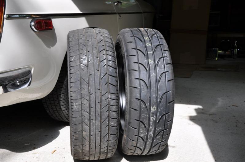

Gundy
I had a tiny bit of toe OUT when the tire on the left was used. That wear pattern was with less than 1000 miles on new tires!
I adjusted the alignment for 1/16 toe IN and I'm getting pretty uniform wear on the new tires, one of which is shown on the right.
The car is less darting prone as well.

Mine have 1/16 inch toe in.
Must be the inner A arm bushings, so that's the next biggie on my list of things to fix after I get the Datsun back on the road.
