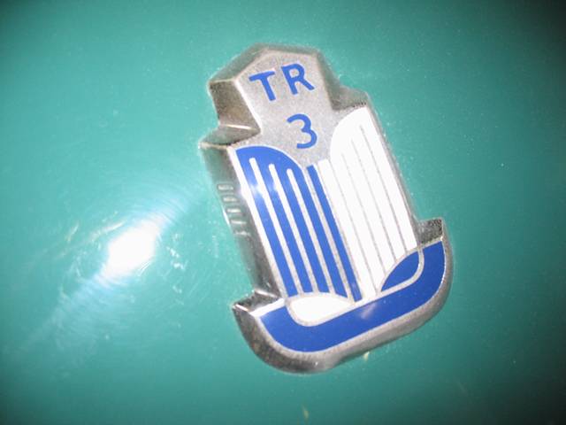

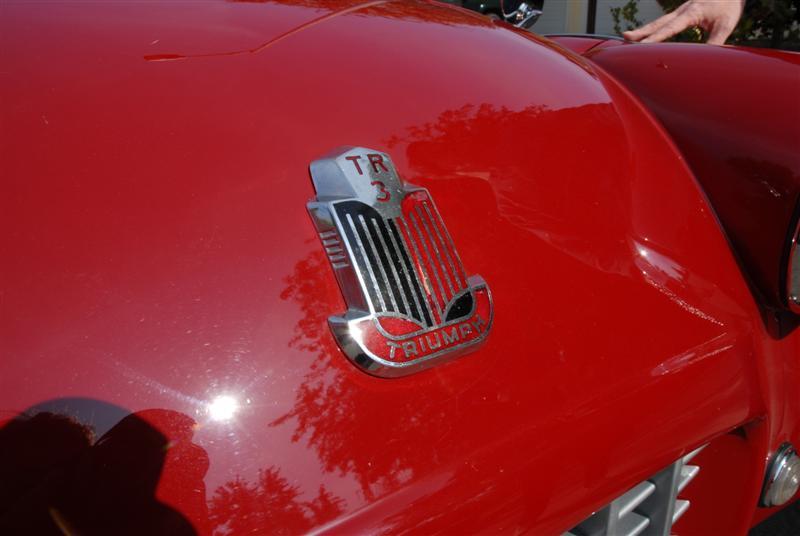

Rusty55 - For a TR3 you should not have any blue on it. If the one on your TR3 was blue and white, it's from a late TR3A and it's not correct for a TR3. It should be red and black with the name TRIUMPH along the bottom.

Between those two were a red and black that did not have Triumph on it because the Triumph lettering was on the hood, used on the early TR3A's in 1958 (mine). Then for a short period in 1959ish was a blue and white that has black in the lower "U".

Mine is TS 62577 L. Can anyone tell me the color it should be? I do have the individual triumph letters on the the front as well. The emblem only says TR3 though.
Should look like the one Don showed above, with blue and white.
None of the badges, etc ever said "TR3A" as the factory never officially recognized that as a model (although apparently some US dealers did call them that). But enthusiasts pretty much universally use the TR3A designation for TS-series cars after TS22013, to indicate the collection of changes that came in at that point, which included the wide grill, the separate TRIUMPH letters, redesigned front apron, changed front bumper, exterior door handles and so on.
Then the "TR3B" designation starts with the TSF- and TCF- cars. The factory did use the TR3B designation sometimes, though not consistently. But AFAIK, the badges still said TR3.
