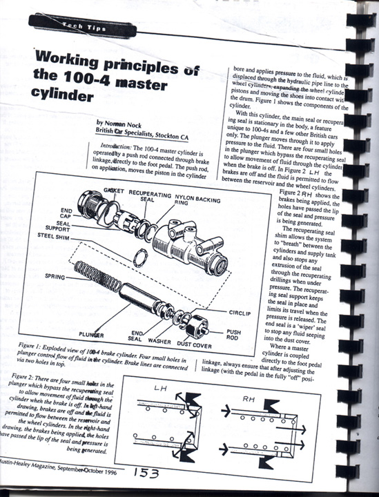

To address the second part of your question:
The BN1, BN2 master cylinder is a very strange arrangement. All of it's parts
must be exactly correct & fitted in the correct order & direction. The
Push rod free play is very critical. .030" to .040". If this is too
little the brakes will not fully release. At worst, the plunger ports
will not be uncovered when the MC is fully retracted, in spite of the
correct clearance, due to recuperating seal swelling or wrong design. Some
folks have slotted the plunger ports to give more retracted clearance
but I have not found this to be necessary.
I have attached Norman Nock's pic of the MC assembly for reference.
D
