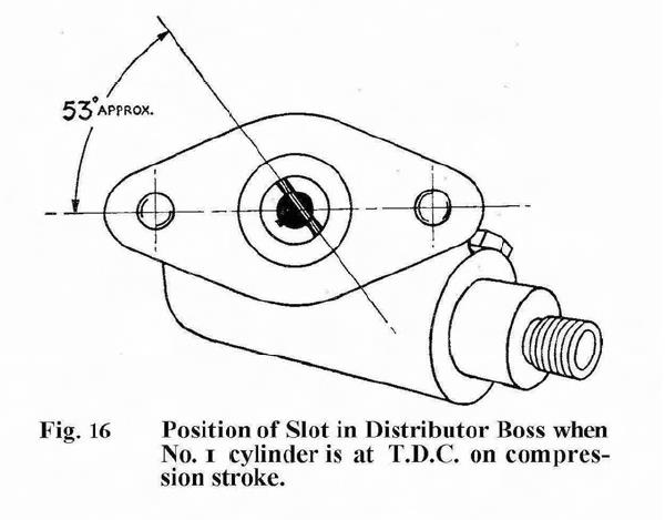

If you look closely at the dog, it is not symmetrical. The blades are slightly offset to one side, and so (of course) is the slot they fit into.
Since the distributor only turns once for every two rotations of the crankshaft, the mark on the crankshaft pulley cannot tell you if #1 is between compression and power; or between exhaust and intake. If the rocker cover is off, it's easy to tell by looking at the valves (both valves will be fully closed during compression and power). Another is to hold your finger on the plug hole while you turn the engine. The compression stroke will force air out the plug hole and lift your finger, but exhaust won't.
Kind of sounds like your old distributor got assembled wrong somewhere along the way, and someone compensated by turning the drive gear. You can, if you want, compound the error by changing the wiring to the spark plugs. But my preference would be to move the gear instead (assuming the problem isn't that the new distributor is assembled off by 180 degrees).

frankfast
You're right I've noticed that the dog is not symmetrical. I've also noticed that according to your illustration and the manual there looks like there is a small keyway in the gear that the distributer dogs fit into. That keyway is 180 degrees offset from the illustration but the original location of the rotor pointed to the first cylinder terminal on the cap with pointer pointing to the mark on the pulley. If the rotor is pointing to #1 cylinder and the pulley mark is at the pointer, is that the compression stroke or could it be 180 degrees from where it should be? If I am on the compression stroke then the gear or distributer is assembled incorrectly. Also, does the crank rotate clockwise when facing the motor?

Another possibility (from your description) is that the distributor cap was previous rewired to compensate for the gear being turned wrong. But if the engine ran, and the rotor pointed to the terminal that was actually connected to #1, and the engine has not been turned since then; it pretty much has to be #1 on compression.
BTW, the illustration above is from the workshop manual.

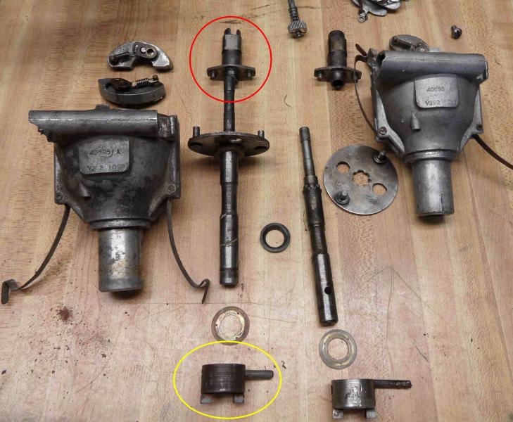

TexasKnucklehead
The orientation "180 off" is arbitrary. It can be "180 off" (or "corrected") numerous ways. I have attached a picture of two "original" Lucas distributors mostly taken apart. The part on top (the top hat) where the rotor would fit, or the part on the bottom that engages with the drive gear, can be rotated 180. I have circled the top with red, the bottom with yellow, but either color is equally incorrect. -Both could be rotated 180, and then it would be off by 360, or 0 depending on how you want to look at it.

frankfast
That pretty much answers the question. Since I've never taken apart a Lucas distributor I thought the dogs at the bottom and the top of the shaft that the rotor fits on were fixed. I didn't know that they could be rotated. So even if the slot into which the distributor dogs engage was off 180 degrees the rotor could still be directed at the #1 cylinder which I always thought was correct.
Again, I don't think that it matters that the rotor on The Flamethrower distributor points away from the #1 cylinder at TDC on the compression stroke as long as it's pointing to the terminal that carries the wire to that cylinder.
