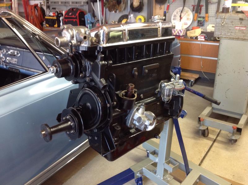

Bronze
I used semi-gloss on the block and gloss on the timing cover and pulleys. My TR4A is a '66 that I bought in '67 so I think it's very close to original.
