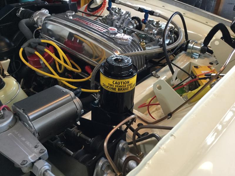

After I saw the mess that occurred over the years in the paint beneath the reservoir, I went with DOT 5!
Before:
and after:
