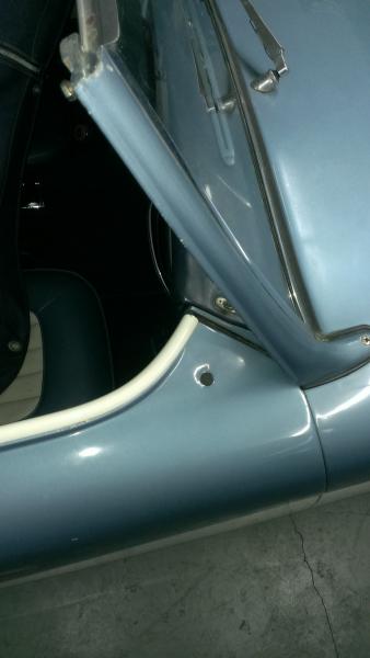

I have a 57 100-6 and can't find what part I need to fill in this hole. Victoria British said they don't have the part and can't find it in the Moss catalog.
Can someone tell me what to use.
The mirrors are on the fenders. Did a previous owner relocate the mirrors leaving the holes open?

Thanks Keith for the link, I must of looked through both catalogs 5 times and overlooked it.
