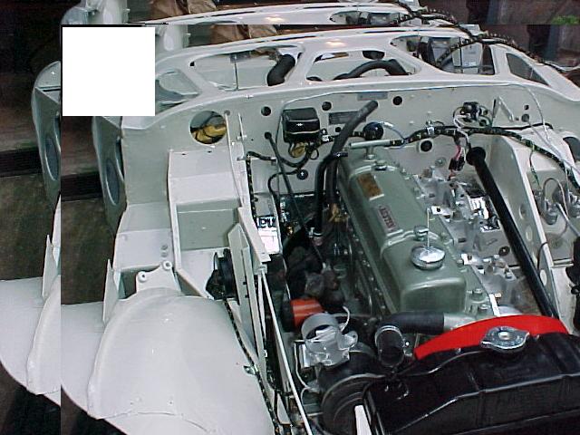

blueridge,very,very nice!radiator fan shroud red paint, brushed or sprayed? the judges are gunna want to know! tell me what ya doin this weekend? /ubbthreads/images/graemlins/cheers.gif
jlaird
I think that must be a pic form the orginial assembly line, except that it is nicer. Must be a special.
BlueRidge1
[/ QUOTE ]
Thanks Red is sprayed. We are headed to the Mountains (Jonas Ridge) Snow tubing, If I live through that I need to get the under side of the shroud and fenders painted so I can start fitting every thing together. (If it looks as if there are two cars in photo, 2 pictures were overlapping when I tryed to edit.
Still new at attachments .
