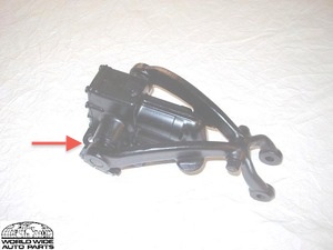

Is my car doing something that is making the shocks leak? Or do I have incredibly bad luck.
Here's the time line.
5.10.10 bought left and right remanufactured lever shocks from World Wide Auto Parts.
8.26.10 right shock leaks. Replacement sent and installed.
2.24.11 right shock leaks. Replacement sent and installed.
6.18.12 right shock leaks.
When installed, all shocks were bolted down tight and travel was smooth. Checked the right shock today, 6.18.12 all four bolts are tight, travel is smooth.
What should I look into?
Why is this happening to the right side only?
The leak is coming from the left side of the shock, where it rotates.

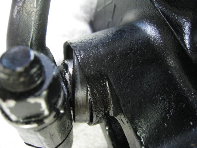

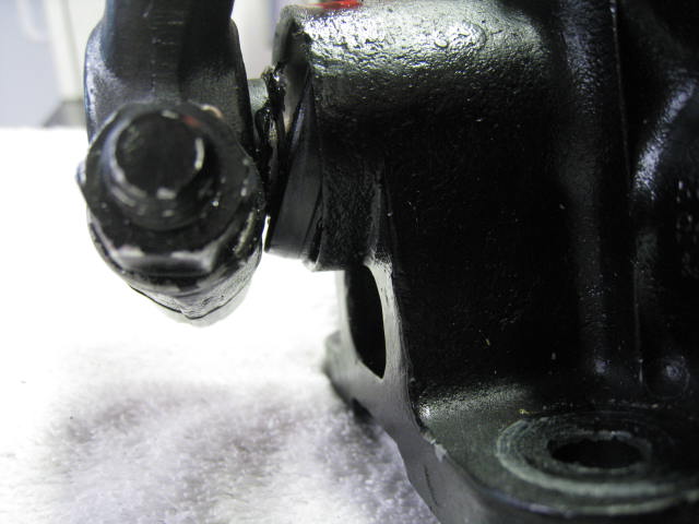

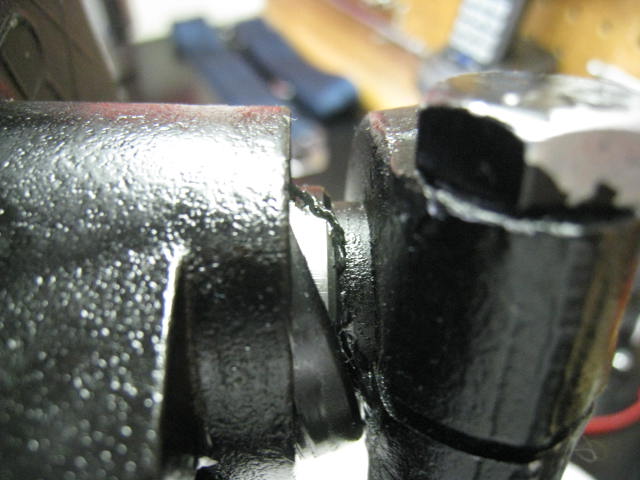

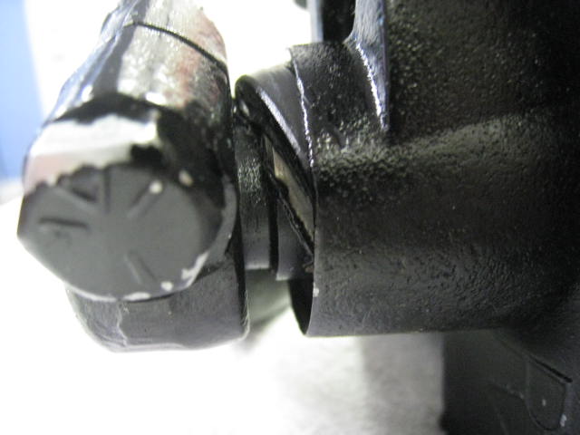

The 5th shock which was installed on 06.26.12, is now leaking... 09.17.12.
Called World Wide Auto Parts and talked to Peter. He sent me another one.
I installed it last night.
Here's some photos showing the seal on the left side of the shock is coming out (all shocks leaked on the left side of the shock, passenger side of the car).
Last month, I got together with a british mechanic and we took the spring off the passenger side, to make sure the front shock was traveling up and down correctly and not binding. Travel was good. We looked at the mounting plate and it looked fine. It appears not to have been in any accidents, looks factory. Everything looks lined up correctly and no resistance in travel. All four mounting bolts were snug.
Thoughts?

Are you sure you are getting a different shock back? I would suggest marking your shock before sending it in to ensure you are getting a different shock.

So, why is the seal popped completely out? Is there pressure buildup that the original packing could handle, but not a tight seal? Seals don't just come out...unless they don't have a good outer edge. Those look like rubber on the outside, and anytime I ever had seals pop out on other applications, they were rubber outers.
Suggestion.
Find a flatwasher that clears the shaft, and is the size of the bore, see if it will fit in against the seal enough so you can stake it into the bore and hold that seal in place.
Dave
