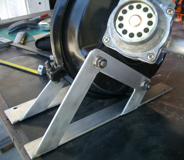

Well, guys, I need your help again. I have started installing the new brake servo unit that I recently purchased - a PowerTune brand made in the UK that the unit and brakets look exactly like the Lockheed unit pictured in the Moss catalogue. According to the sales company, this unit comes with a bracket kit that makes it a simple install using the original mounting points for the old girling unit. I cannot figure out how the provided bracket could be used to mount this thing up without some major bending and drilling of new holes in the provided bracket. Have any of you installed one of the Lockheed or PowerTune units? I have been running without a brake servo since the mid-seventies but decided to reinstall one as one of this winter's projects. I still have the original mounting brackets on the car, if that is useful at all. Thank you all for your assistance over the years and wishing you a great, Happy New Year!
GregW
Platinum
Hi Steve,
I had a similar problem with my PBR unit. Well, the brackets fit the booster to the footwell, but the booster wasn’t level. I wound up making some brackets instead of trying to get the supplied ones to work. Just one road you can take.
S
stever
Thanks, Greg. Those are nice looking brackets! So far, I figure I could bend the supplied bracket to make the "angle" better and drill a few holes so they mount on the existing bolts, but I didn't think that was necessary. The drawing of the bracket in the Moss catalogue is the same as what was supplied. I am wondering if I just am not seeing straight and sometimes I have difficulty visualizing how things should look when assembled - I have trouble with picture puzzles, for example.
