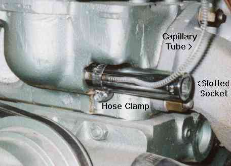

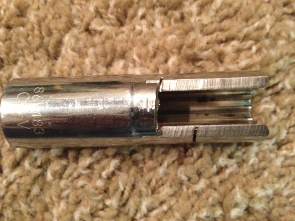

Is there like a special wrench that is required to get to the water temp fitting on the head? I have a stubby wrench but the open end wont fit in the narrow gap around the nut. The only way I can see is to slice a section out of a socket and make an open end style socket to allow it to be removed. Any body have a solution or how have others removed the temp bulb out of the head. Is there anything on the big healeys that is simple to work on?

yes you could ge a 5/8 socket and cut a wedge out of it or ge a stubby 5/8 wrench and cut a slit in it in order to let the temp wire go throughit will fit

The socket is a good solution. You must put a hose clamp around the socket to keep it from spreading when your removing the temp bulb. I've seen a photo of the modified socket and I'm sure womeone will chime in with it.

Yes, cut out the socket. I used an old sparkplug socket, cut it with a Dremel and it worked just great. Soak the fitting with PB Blaster to make the removal even easier.

I saw this tool posted on the net a while back to remove the temp sensor bulb.
