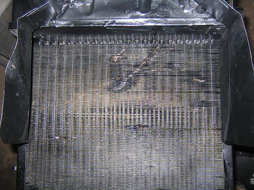

Here is the toasted radiator after the fan came apart. THe only thing that I can see is that the fan might have caught a braided breather line and came apart. Dunno, it could have hit the line during the break up as well. The line is now way out of the way and tied back to mack sure this is never the problem. A new fan is on order, but I have to see about having the radiator fixed. When the fan broke apart it got into the radiator; puncturing a few of the tubes. I will have to take it in a see if it can be fixed and for how much.

I wouldn't consider that radiator 'toasted' until I took it to a radiator repair shop...you'll be surprised what they can do!

Agree with Tony, that radiator can be fixed easly.

I don't believe that radiator needs recoring!
jlaird
Noop agree, bet those holes can be soddered and fins straightend out for cheep.

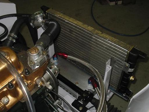

Nope not a VW radiator, they are all crossflow with side tanks, look some sort of custom, doesn't even look like a Ron Spridget unit to me. Here's a picture of one of the popular VW radiators used in Spridgets, this one is a VW Rabbit non/ac late 70s/early 80s, the other popular one is the Scirroco, it's wider and has a inboard filler neck, either VW unit mean getting rid of all the existing Spridget radiator shrouding, but they are great radiators, in the Valeo brand (plastic side tanks, aluminum core), hard to find these days, this radiator only weights 5 pounds.

I run a VW unit from a '77 Scirocco in my BE! As Hap says install requires some mods, but it works very well!! (Of course, I saved the parts and can always retrofit back to original!).
mccalebr
Here's the Ron Davis unit I'm installing in my Spridget Project ('62 Sprite). It's not the cheapest alternative and will require an expansion tank (I'm using the round Moroso aluminum one) but it fits well, requiring only a couple brackets be made to attach it to the top of the existing uprights and a clip to hold the bottom tight.

Yeah, need to hook a hose between the two hose fittings and pressurize it and see where the leak is. If its one of the tubes on the front, you can clean it up and fix it with a propane torch and solder.
